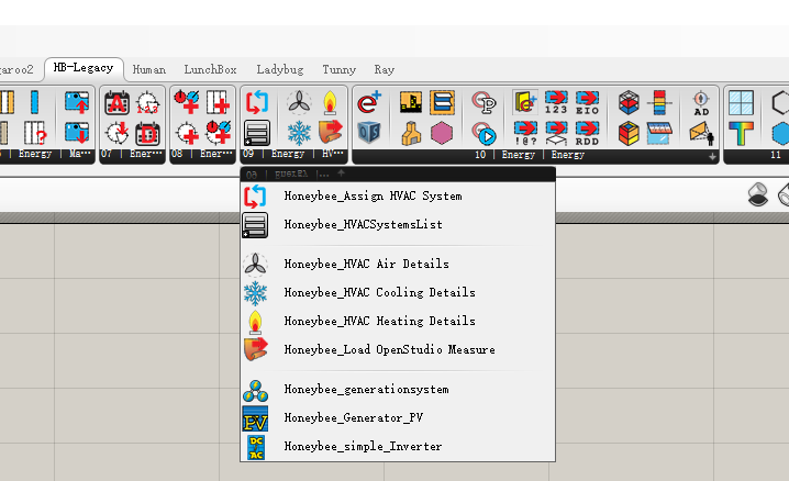

As I know ther are no PV related componets in Ladybug tools Version 1.5.0 . But ladybug legacy Version 0.0.69 and Honeybee Version 0.0.66 have some PV simulation components.
Thanks @minggangyin , I made a script out of them which worked but unfortunately it seems incompatible with Rhino 7. It hangs for hours even though it showed results before. (and no components show a problem)
