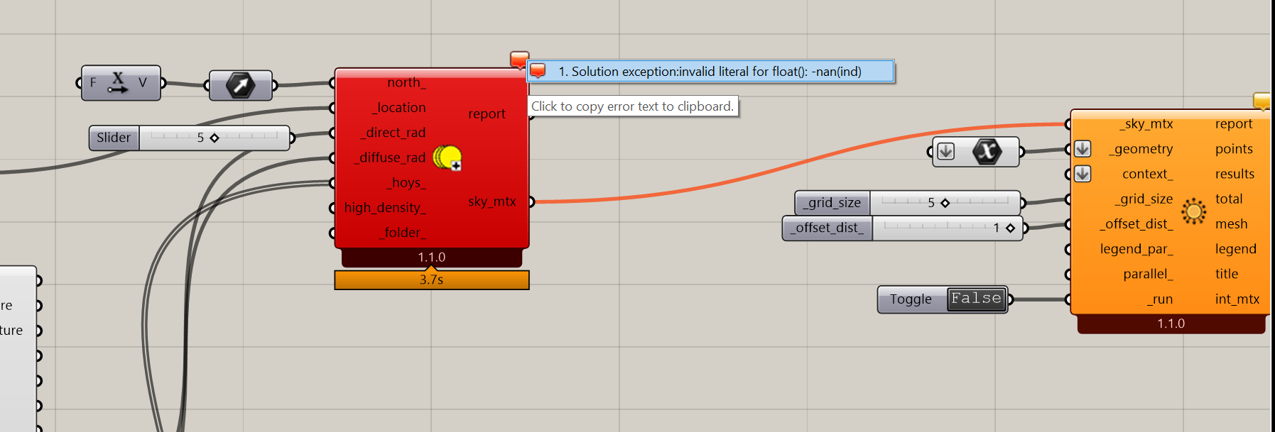

Am I doing something wrong? Maybe it are my installations of OpenStudio and other installations needed to run some components of ladybug.
Do you see what I am doing wrong?
For the gh-file, please see

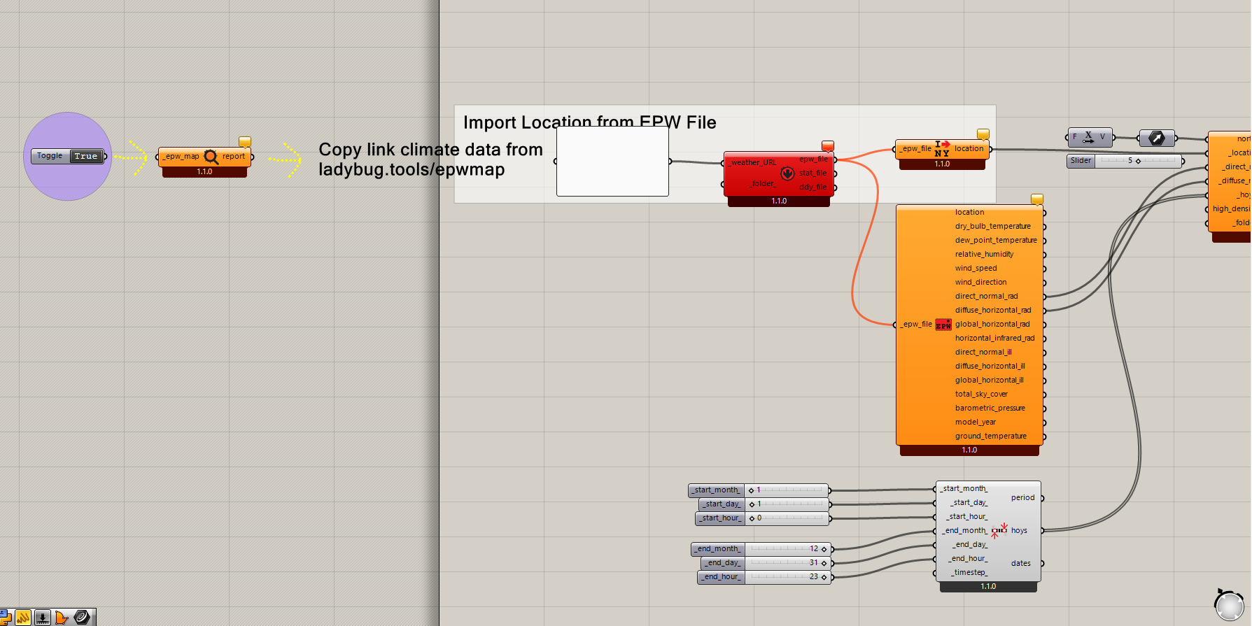

Hi @rabbit
I modified and attach your file.
In general, you canβt copy links from climate.onebuilding, and other websites. The method of creating a link is available in the attached file. Also enter the _direct_rad and _ diffuse_rad inputs correctly.
Edit.gh (66.0 KB)

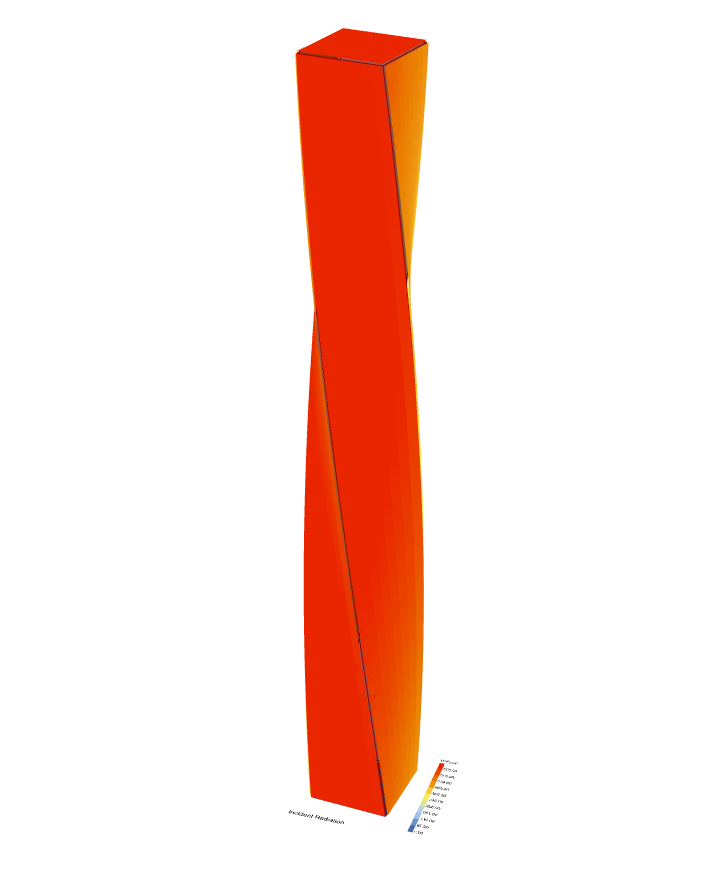

Do you might know why the mesh is not fully colored
What I am doing wrong?

I opened it and it looks like this. Maybe it are my rhino settings
You scaled it but your image looks great.
Might it be brep or mesh? I did not change something.
