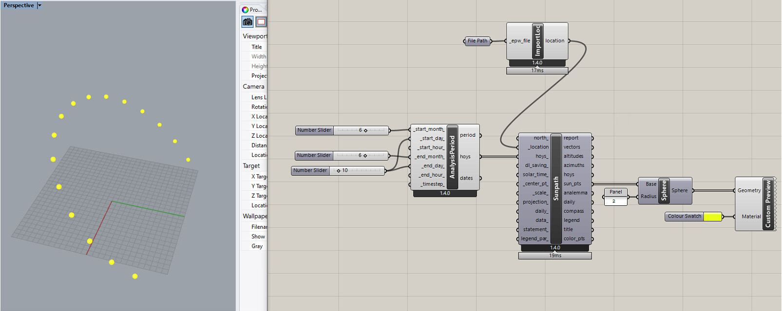

How do i change the red points to yellow suns?
You need to use Grasshopper native components. The same component that creates this sun path has an output called “Sun pts” (sun points).
To make them look like spheres, use the Sphere component.
To make the spheres yellow, connect the to a Custom Preview component and use a yellow Swatch

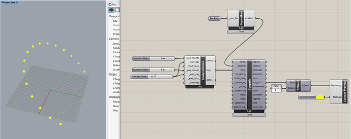

BE CAREFUL: too many points may result in a long calculation time. I would suggest setting a desired period for the Sunpath, as shown below.
Thank you so much !!!
