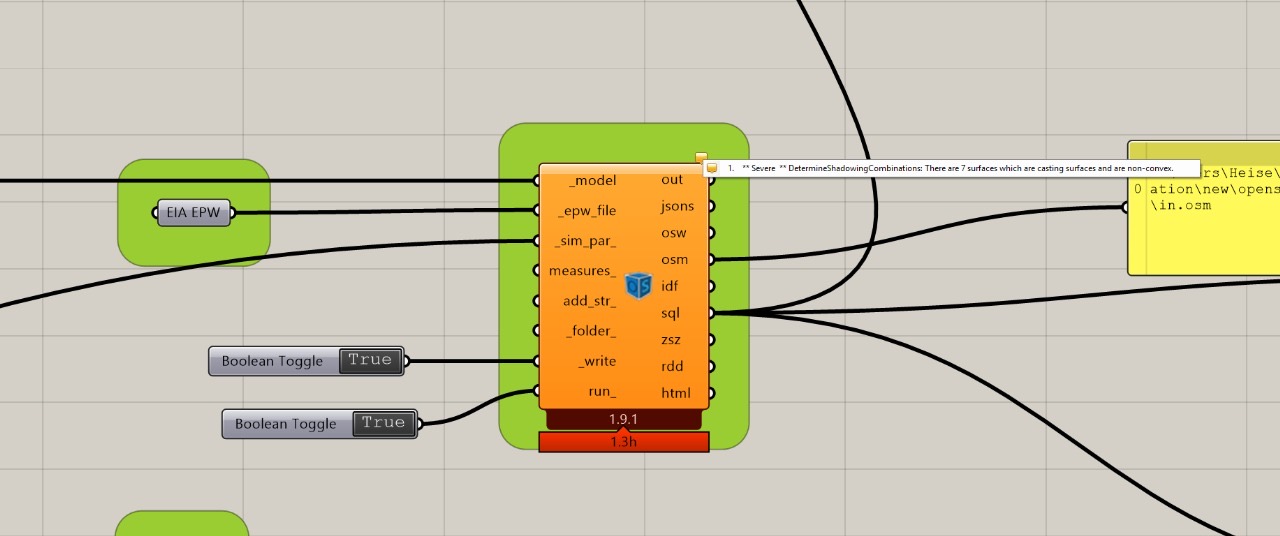

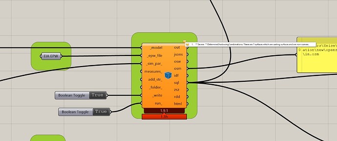

Can you join a panel to the output and write here the message of the Severe error indicated?
