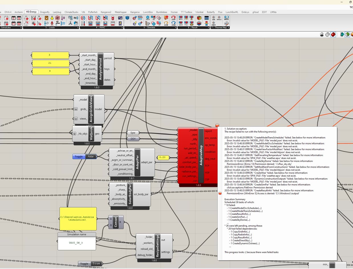

I’m trying to run an Adaptive comfort map script. But something strange happens when I add the “recipe settings” component:
I know it looks a bit messy, but without the recipe connected to run settings, the component runs fine. And I get results. However, I would like to have the ability with more workers to run simulations faster, to see a debug report if something comes up, and I would like to save my simulation files in a specific folder that is not in my C:\Users

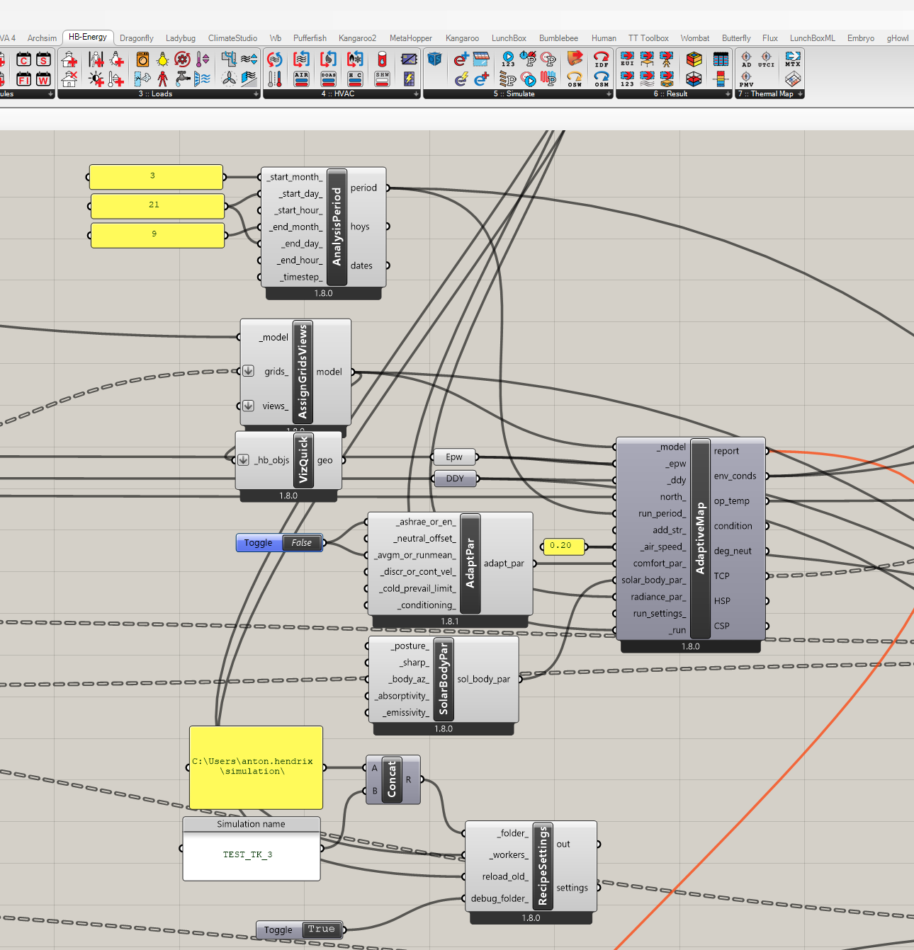

Hi @AntonH,
The debug folder is supposed to take a path as input. What happens if you set the debug folder as C:\Users\anton.hendrix\simulation\TEST_TK_3\debug?
