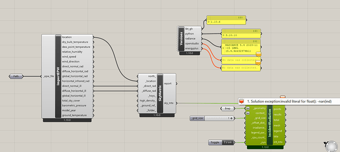

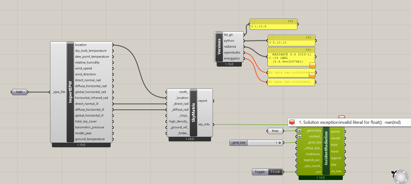

I’m getting the following error when running LB Incident Radiation:
Solution exception: invalid literal for float(): -nan(ind)
My setup:
  • Rhino units: millimeters
  • Geometry: Flat planar srf.
What I have tried:
  • Flipping the surfaces with the Flip component
  • Disconnecting and reconnecting all inputs one by one
  • Adding a grid size slider
The component turns red and results output shows Null. No other errors present except a warning on _grid_size before I connected the slider.

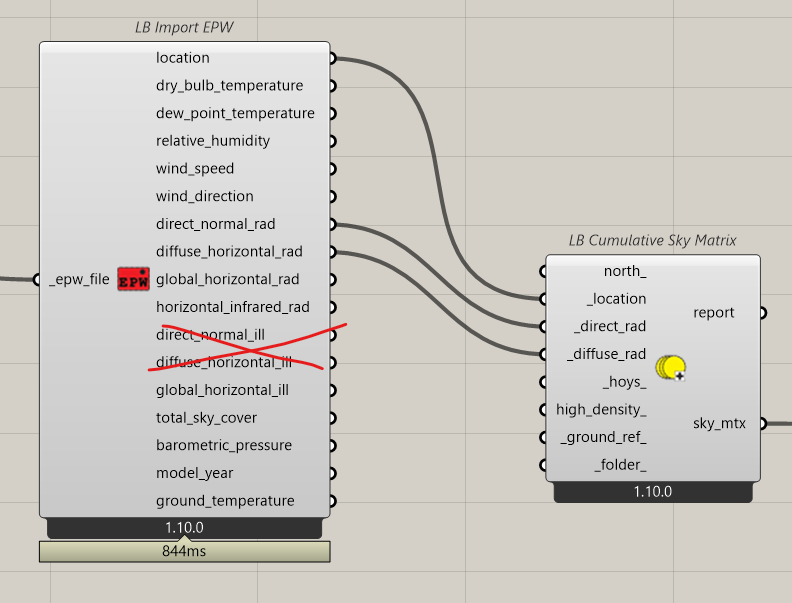

The issue is the input in the cumulative sky matrix. You need the direct/diffuse radiation, not illuminance. See the image.
Aaaah Wow. Thx Mikkel. You are a savior!
