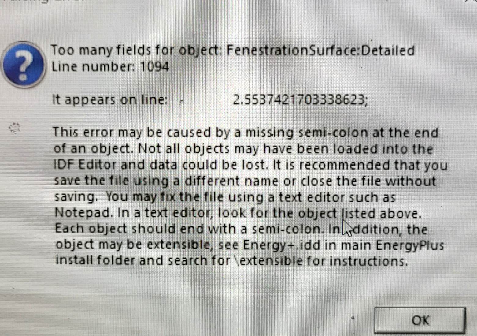

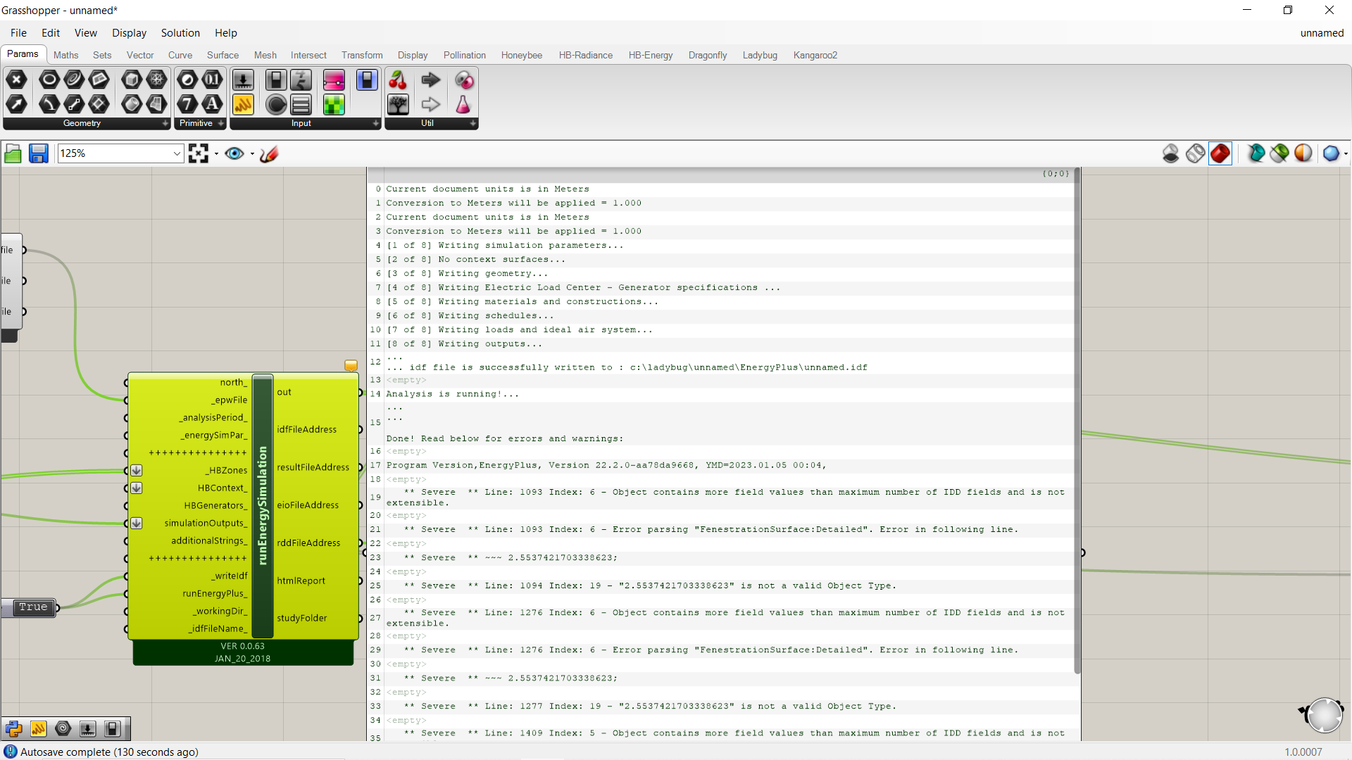

I am getting the following errors while running energy plus. Hoping to get some help.

I am new at this. so might be missing a lot of info. my questions are,
I tried with the simplest geometries but still got errors. Guessing if it’s a compatibility issue. Wanted to know if the EP 22.2.0 version is compatible with the updated legacy tools and Rhino 7 I tried EP 9.4, but it did not help.
I don’t see any version mentioned in the IDF file; I wanted to know if that’s a significant error.
I got an error notification while opening the IDF file. It’s the third screenshot.
