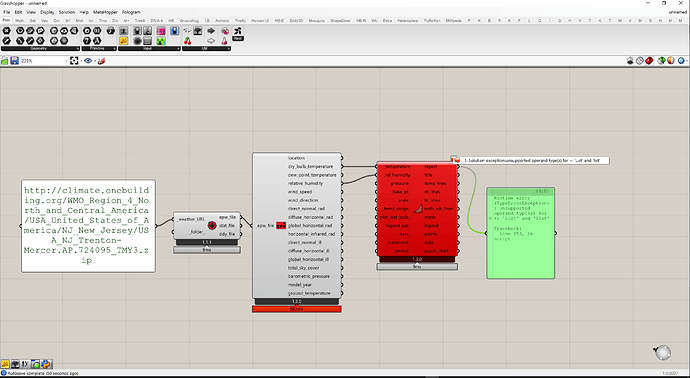

Dear LB community,
I recently updated my LB to 1.3.0 (or 1.35.9 shown in the folder structure) with the one-click installer, and LB Psychometric Chart component is throwing me an error - "1. Solution exception: unsupported operand type(s) for +: ‘List’ and ‘list’ " - when I use dry bulb and rh for input. I have tried to uninstall and delete previous LB versions and associated user objects and files. Somehow the error persists. Attached is the screenshot for reference. I am using Rhino 6.
Many thanks! Do let me know if there is anything else I can provide in support of this.
@mostapha, @MingboPeng
This is one of our students who is experiencing this error before and after using the 1-click installer. Any insight with what could be wrong?
A possibly related issue is that he has also has mentioned he’s run into errors trying to download Rhino 7 that he hasn’t gotten resolved with McNeel technical help. That problem, along with the reference to the “List” type in the error message (a type in C# but not a type in Python) makes me wonder if there’s a deeper error related to Rhino or .Net. If so, perhaps @wim might have some insight here.

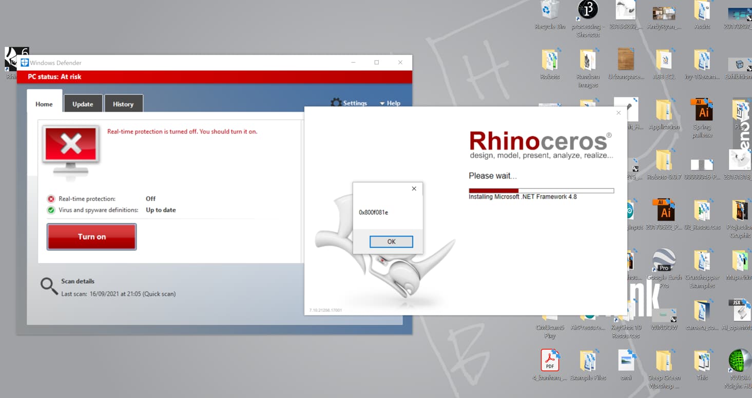

Sorry I was imprecise, he ran into an error while trying to install Rhino 7. I can share the information he provided:
Screenshot of error:
And log file:
Rhino_7_20210917134035.log (32.7 KB)
@zwang please correct my summary of your error or provide more information as required.

I found a conversation with tech support from September 17th where Japhy from McNeel writes:
Zherui,
This is what the log analysis recommends
  1. Cause: Failed to run a program included with the installer. The installer is trying to run a critical part of the installation process, but may be being blocked by antivirus or malware protection software.
  2. Solution:* Temporarily disable your virus scanner, then run installer again.
But there is no further answer from the user in that conversation. Does the screenshot say that the suggested solution was tried but did not help? Was the error message different with Windows Defender turned off?

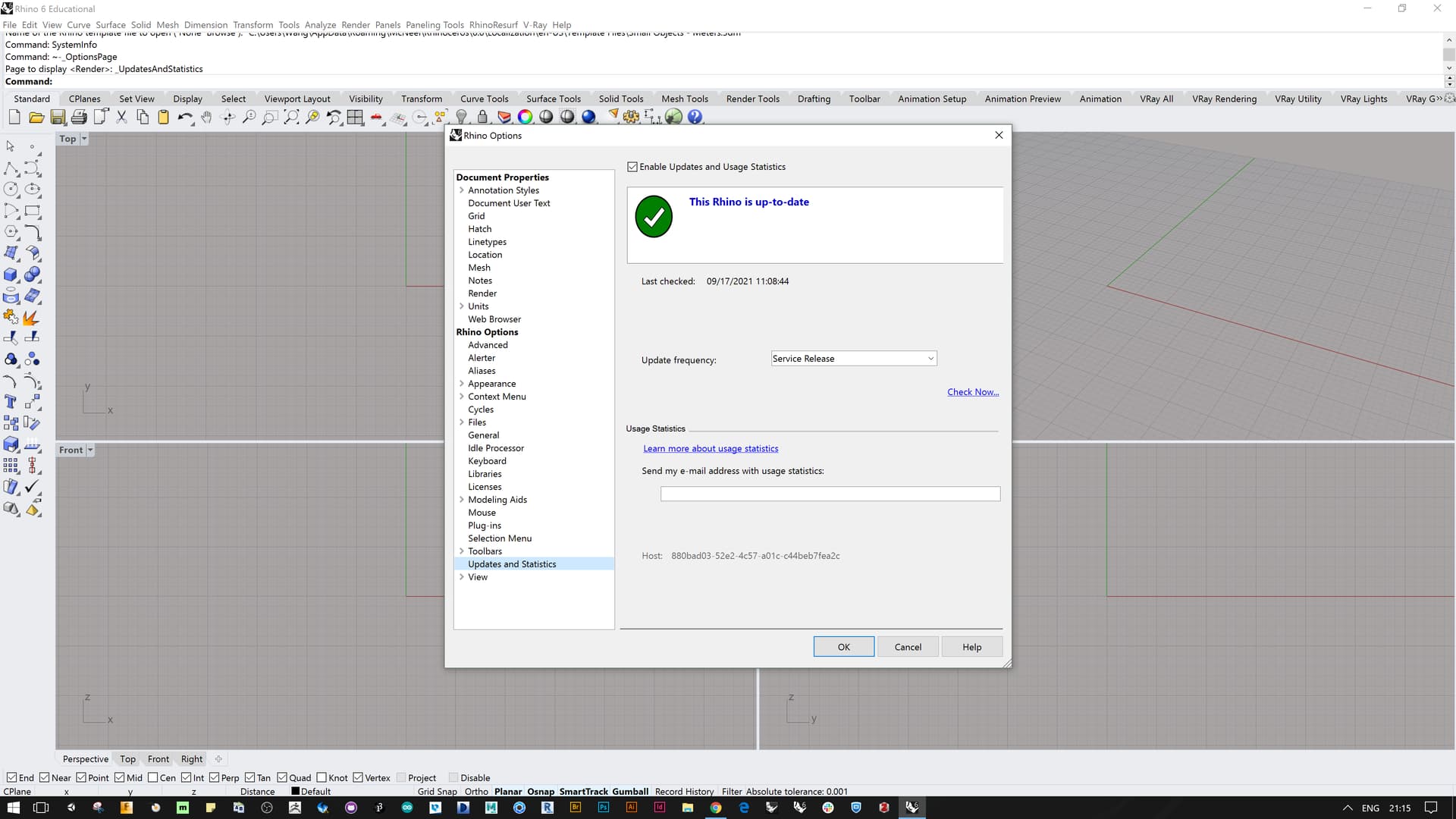

In Rhino 6, please run the Rhino SystemInfo command and copy-paste the result here.
-wim
Interesting. This must be an issue from an earlier version of GHPython before the .NET List type and the IronPython list type were reconciled with one another. This is the line that’s failing:
All that is happening there is that one of the inputs with List Access is being combined with a native IronPython list.
I verified that the issue does not exist in the latest Rhino 6 service release from McNeel. So my suggestion is just to update your version of Rhino 6 service release and then everything should work.

Wim, yes, the screenshot suggests that the problem persists even if the Windows Defender and system firewall were turned off.
Chris, I have doubled check my R6 versions again and I have the most updated Rhino. SystemInfo shows that R6 SR 35 is on my machine (dated to 2021-08-10). I have attached screenshot and systeminfo texts here for reference.
Many thanks.
Rhino 6 SR35 2021-8-10 (Rhino 6, 6.35.21222.17001, Git hash:master @ 073ac7b225c67348731c6597127b9410126c3139)
License type: Educational, build 2021-08-10
License details: Cloud Zoo. In use by: zwang2 ()
Windows 10.0.0 SR0.0 or greater (Physical RAM: 64Gb)

Hi -
All this sounds like an issue with the .NET installation on your computer.
First, make sure to install all Windows updates.
If that doesn’t help, try the Microsoft .NET Framework Repair Tool.
-wim
While you guys are getting to the root cause of the issue, I just wanted to offer a potential workaround if you need it. Replacing that line of code with the following should temporarily fix the issue:
all_data = [d for d in data_] + [temperature, rel_humid]
If we have to, we’ll change that line of code in the official code base but hopefully wim’s suggestion solves it and we can leave the component as it is.
@wim I made sure my Windows was updated and downloaded MS. NET Framework Repair Tool per your suggestion. Neither seemed to be able to resolve R7 installation issues. Bellow are the logs generated. Sorry for the long post since I’m not able to upload files onto the forum here.
Many thanks again!

[2D04:142C][2021-09-24T15:03:51]w343: Prompt for source of package: NetFx48Redist, payload: NetFx48Redist, path: C:\Users\Wang\Downloads\redist\ndp48-x86-x64-allos-enu.exe
[2D04:142C][2021-09-24T15:03:51]i338: Acquiring package: NetFx48Redist, payload: NetFx48Redist, download from: https://files.mcneel.com/rhino/7/redist/ndp48-x86-x64-allos-enu-sha2.exe
[3B9C:20D0][2021-09-24T15:04:10]i305: Verified acquired payload: NetFx48Redist at path: C:\ProgramData\Package Cache\.unverified\NetFx48Redist, moving to: C:\ProgramData\Package Cache\584FFD3BBB7F73CD149E4486F6465C838D847450\redist\ndp48-x86-x64-allos-enu.exe.
[3B9C:20D0][2021-09-24T15:04:11]i304: Verified existing payload: rhino.msi at path: C:\ProgramData\Package Cache\{B1EFC96A-CBD4-4CBF-ABF9-9381EE39E156}v7.10.21256.17001\rhino.msi.
[3B9C:20D0][2021-09-24T15:04:11]i304: Verified existing payload: rhiexec.msi at path: C:\ProgramData\Package Cache\{015C0ADD-50DC-4B18-9933-6E32DE73FD30}v7.10.21256.17001\rhiexec.msi.
[3B9C:20D0][2021-09-24T15:04:12]i304: Verified existing payload: en_lang_pack at path: C:\ProgramData\Package Cache\{E6B75C3F-25E5-47AC-91A5-62003449615B}v7.10.21256.17001\redist\en-us\LanguagePack.msi.
[3B9C:4B78][2021-09-24T15:04:12]i301: Applying execute package: NetFx48Redist, action: Install, path: C:\ProgramData\Package Cache\584FFD3BBB7F73CD149E4486F6465C838D847450\redist\ndp48-x86-x64-allos-enu.exe, arguments: '"C:\ProgramData\Package Cache\584FFD3BBB7F73CD149E4486F6465C838D847450\redist\ndp48-x86-x64-allos-enu.exe" /q /norestart /ChainingPackage "Rhino 7" /log "C:\Users\Wang\AppData\Local\Temp\Rhino_7_20210924150329_000_NetFx48Redist.log.html"'
[3B9C:4B78][2021-09-24T15:42:31]e000: Error 0x800f081e: Process returned error: 0x800f081e
[3B9C:4B78][2021-09-24T15:42:31]e000: Error 0x800f081e: Failed to execute EXE package.
[2D04:46A0][2021-09-24T15:42:31]e000: Error 0x800f081e: Failed to configure per-machine EXE package.
[2D04:46A0][2021-09-24T15:42:31]i319: Applied execute package: NetFx48Redist, result: 0x800f081e, restart: None
[2D04:46A0][2021-09-24T15:42:31]e000: Error 0x800f081e: Failed to execute EXE package.
[3B9C:4B78][2021-09-24T15:42:31]i351: Removing cached package: NetFx48Redist, from path: C:\ProgramData\Package Cache\584FFD3BBB7F73CD149E4486F6465C838D847450\
[3B9C:4B78][2021-09-24T15:42:31]i372: Session end, registration key: SOFTWARE\Microsoft\Windows\CurrentVersion\Uninstall\{0a3a1bf0-324b-4267-b9ed-80f9649f569e}, resume: None, restart: None, disable resume: No
[3B9C:4B78][2021-09-24T15:42:31]i330: Removed bundle dependency provider: {0a3a1bf0-324b-4267-b9ed-80f9649f569e}
[3B9C:4B78][2021-09-24T15:42:31]i352: Removing cached bundle: {0a3a1bf0-324b-4267-b9ed-80f9649f569e}, from path: C:\ProgramData\Package Cache\{0a3a1bf0-324b-4267-b9ed-80f9649f569e}\
[3B9C:4B78][2021-09-24T15:42:31]i371: Updating session, registration key: SOFTWARE\Microsoft\Windows\CurrentVersion\Uninstall\{0a3a1bf0-324b-4267-b9ed-80f9649f569e}, resume: None, restart initiated: No, disable resume: No
[2D04:46A0][2021-09-24T15:42:32]i399: Apply complete, result: 0x800f081e, restart: None, ba requested restart:  No
