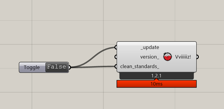

LB Sky matrix- Solution exception:Type must be plastic not Plastic
I am trying to use the LB 1.1.0 Cumulative SKy Matrix component. I am getting this error, whether it is connected to any component, or not.
  1. Solution exception:Type must be plastic not Plastic.
What might be going wrong?
Hi @JG ,
The recent update fixed some issues in schema, you will need to update the standards library along with plugins. You just need to set “clean_standards” to true, it will remove old version of standard.
