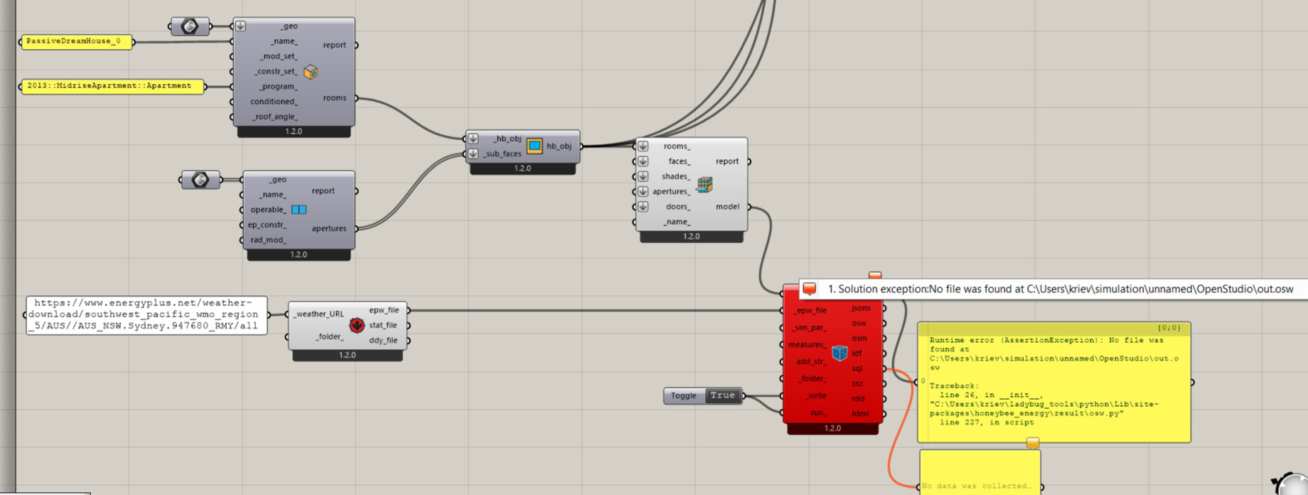

First of all it is challenging to translate video tutorials into Ladybug Tool 1.2.0 as it is in LB and HB Legacy. Is there any guide of transition and functions?
I succeeded somehow so far but can’t cope with energy simulations as I am getting errors at the same beginning already. HB model to OSM seems to write file but I get an error when I run it and it errors that there is no file to continue.
I am working at Rhino 7 with built in Grasshopper version. It is Ladybug Tool version 1.2.0 and Open Studio 3.1.0. And I followed installation guide and Compatibility Matrix as stated.
As it didn’t work I try to go back and install Rhino 6 with built in Grasshopper, Ladybug 0.0.69 and Honeybee 0.0.66 Legacy again as stated in installation guide and Compatibility Matrix. I am trying script given by Ladybug Academy but when I try to run Honeybee_Export_To_Open_Studio everything crush and rhino closes down without giving any error report. And I tried with Open Studio 2.9 and reinstalled GPU drivers. No success on any solutions.
Any suggestions on fix or guidelines?
