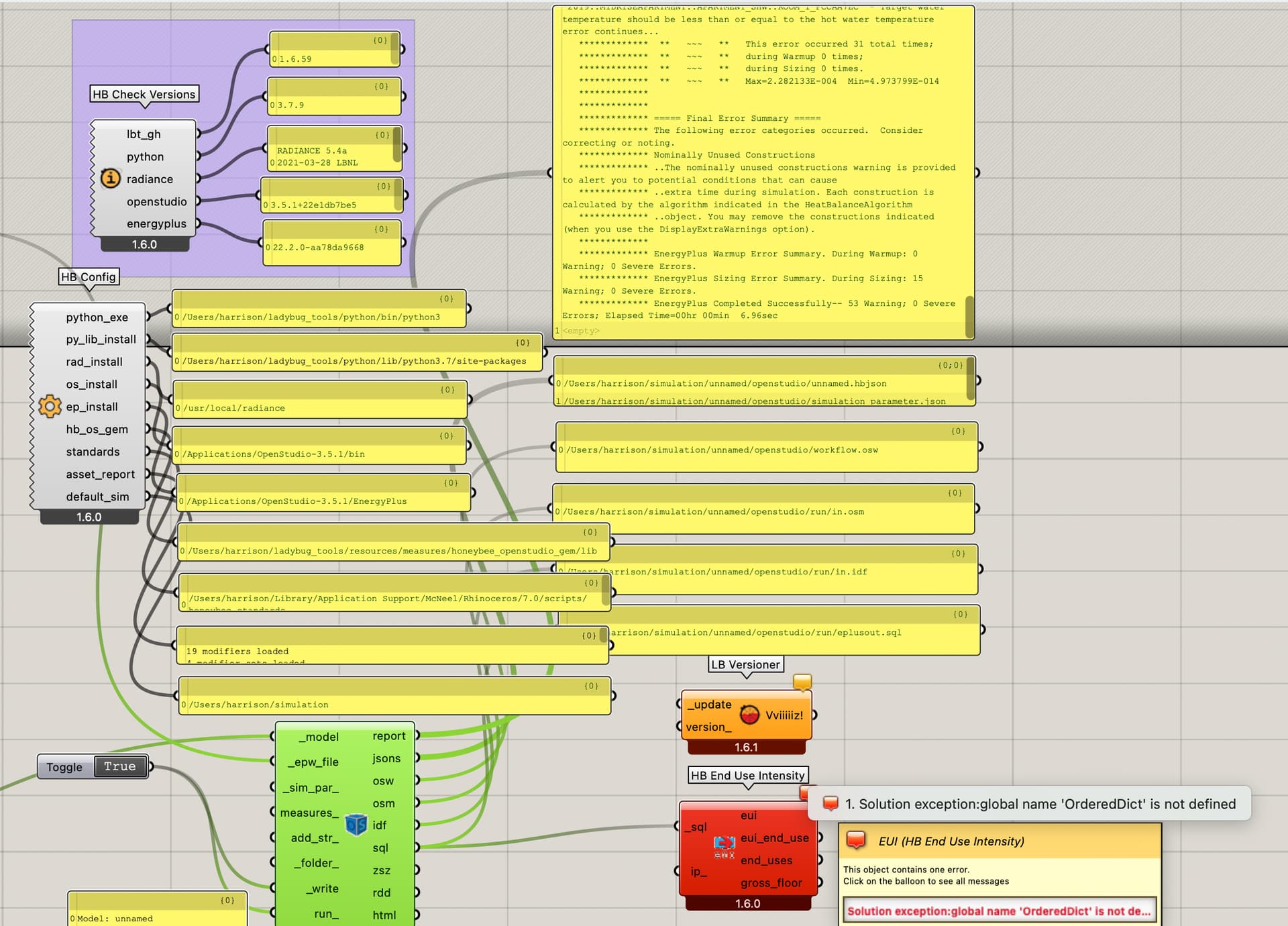

Hi y’all, sorry to jump in on a solved issue, but I’m running into the same thing, both before and after updates using the LB Versioner.
I wondered if deploying it via the published fix on GitHub (instead of the LB Versioner) might work for some reason, but I’m not sure what to do with the Source code.zip folder once it’s unzipped. I’m sure that’s just ignorance on my end, but any help/guidance you can offer would be greatly appreciated. Thanks for all of your hard work on this fantastic tool.
Hi @Harrison ,
The component with the fix will have a version number of 1.6.1 (or greater).
After running the LB Versioner, you will have to drag/drop a new component with this version onto your canvas since the 1.6.0 component is not updated automatically in your older Grasshopper definition. Or you can use the LB Sync Grasshopper File component to automatically sync all of the components on your Grasshopper canvas with the version installed in your toolbar.
Oh man, total facepalm moment on my end! Thanks, Chris – that fixed it right up.
