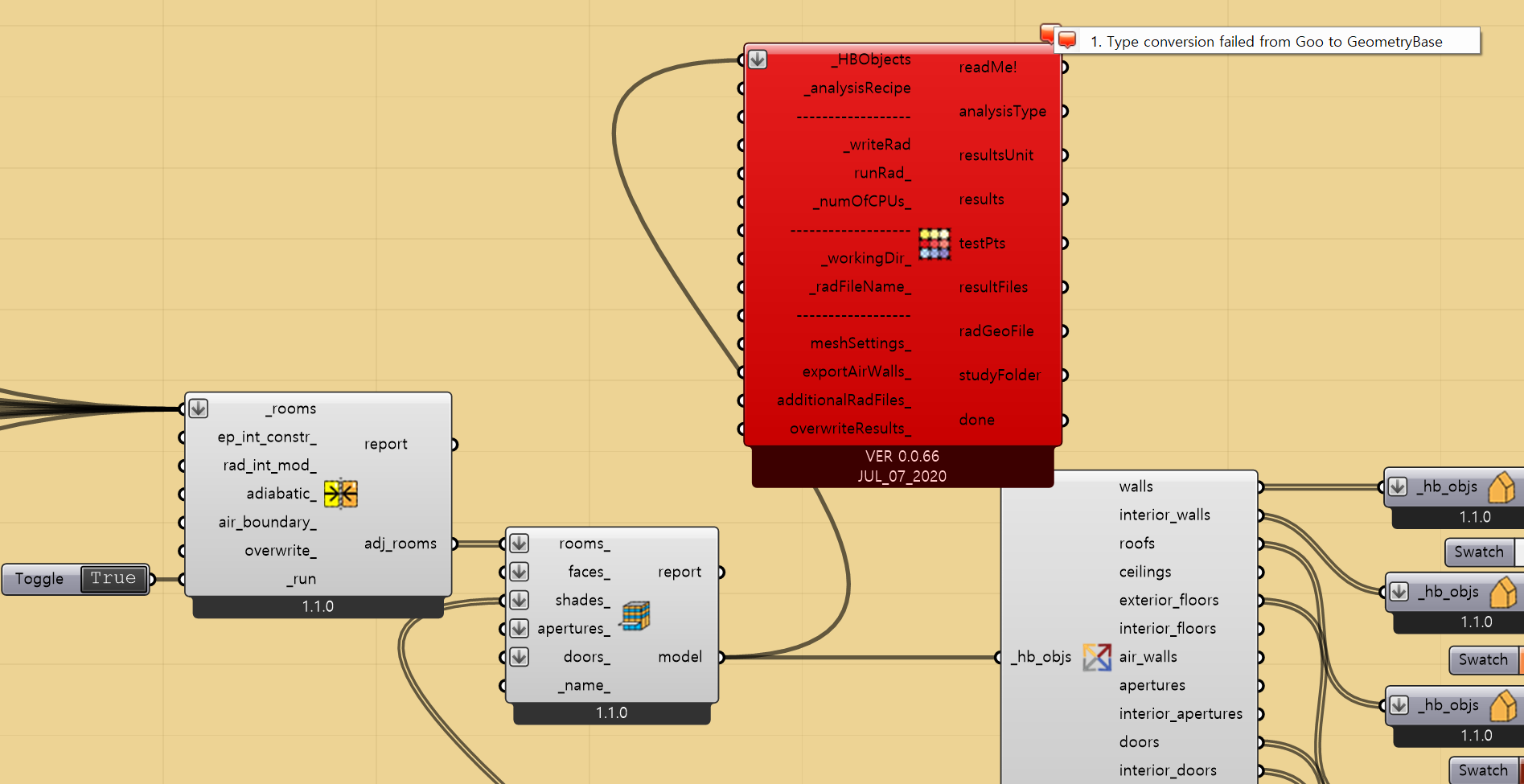

I want to simulate glare analysis and illumination with LBT. But I don’t know how to proceed because I can’t see the parts.
There is a problem when trying to simulate the functionality that you worked with Legacy on LBT. So I wonder if it is desirable to do everything only with a legacy.
At the moment the LBT version does not have the components to simulate glare and illumininace analysis, but it is possible with the legacy version
Greetings
@LaFleur
Thank you for the information that LBT and Legacy can be used together.
So I tried to use it, but there was a problem in that part, so I can’t solve it. May I know the solution?
no, you can´t definitely used both together.
Legacy with Legacy´s components, LBT with LBT.
