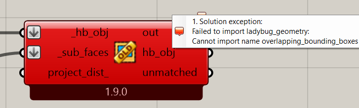

I’ve installed the latest LBTs, version 1.9.0, however, since yesterday all many of the 1.9.0 HB components now read ‘OLD’ and some don’t work with various error messages.

what installer did you use? pollination single click or the one on food for rhino?
I had this issue in one of my workstations. I think you have installed your previous LB tools version using Pollination and now trying to use the GH installer to upgrade.
Please go to ADD or Remove programs in your PC and uninstall the Pollination. Then restart your computer and then try reinstalling 1.9 v.
