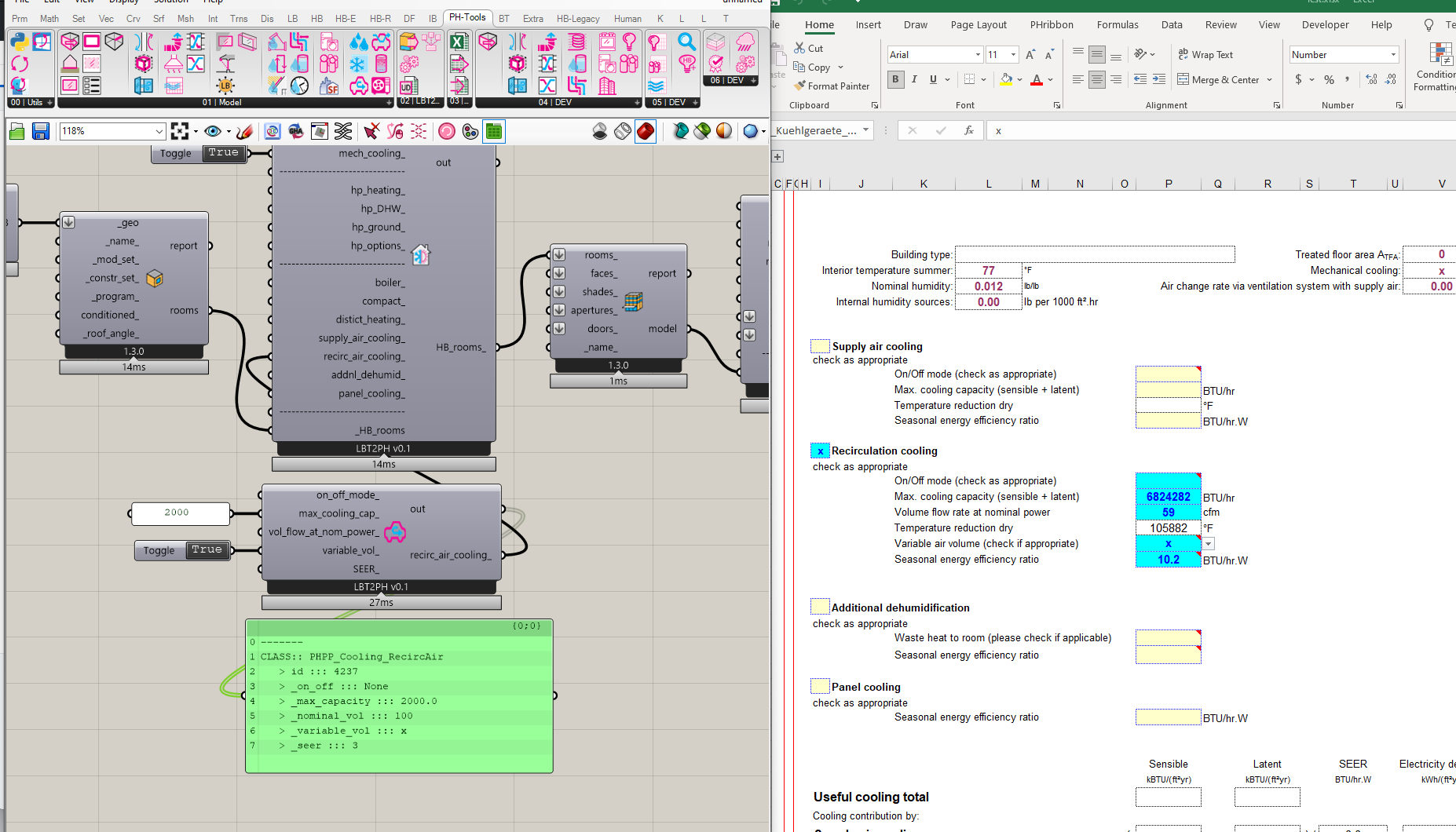

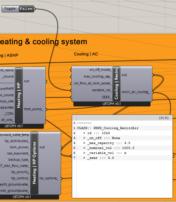

Hi @edpmay, the variable volume setting for the recirculation cooling does not seem to work. I have tried with boolean toggles or “x” - “” panels but it seems to be stuck on “x” regardless. Do you know why?
Thanks!

Thanks for doing that @TrevorFedyna ! That worked great. All seems to be working for me now:

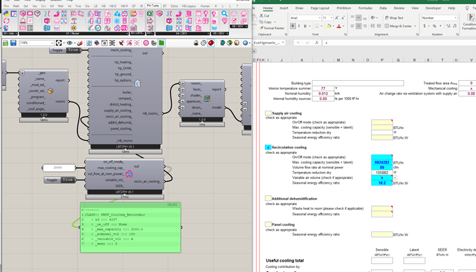

With Variable Volume on:

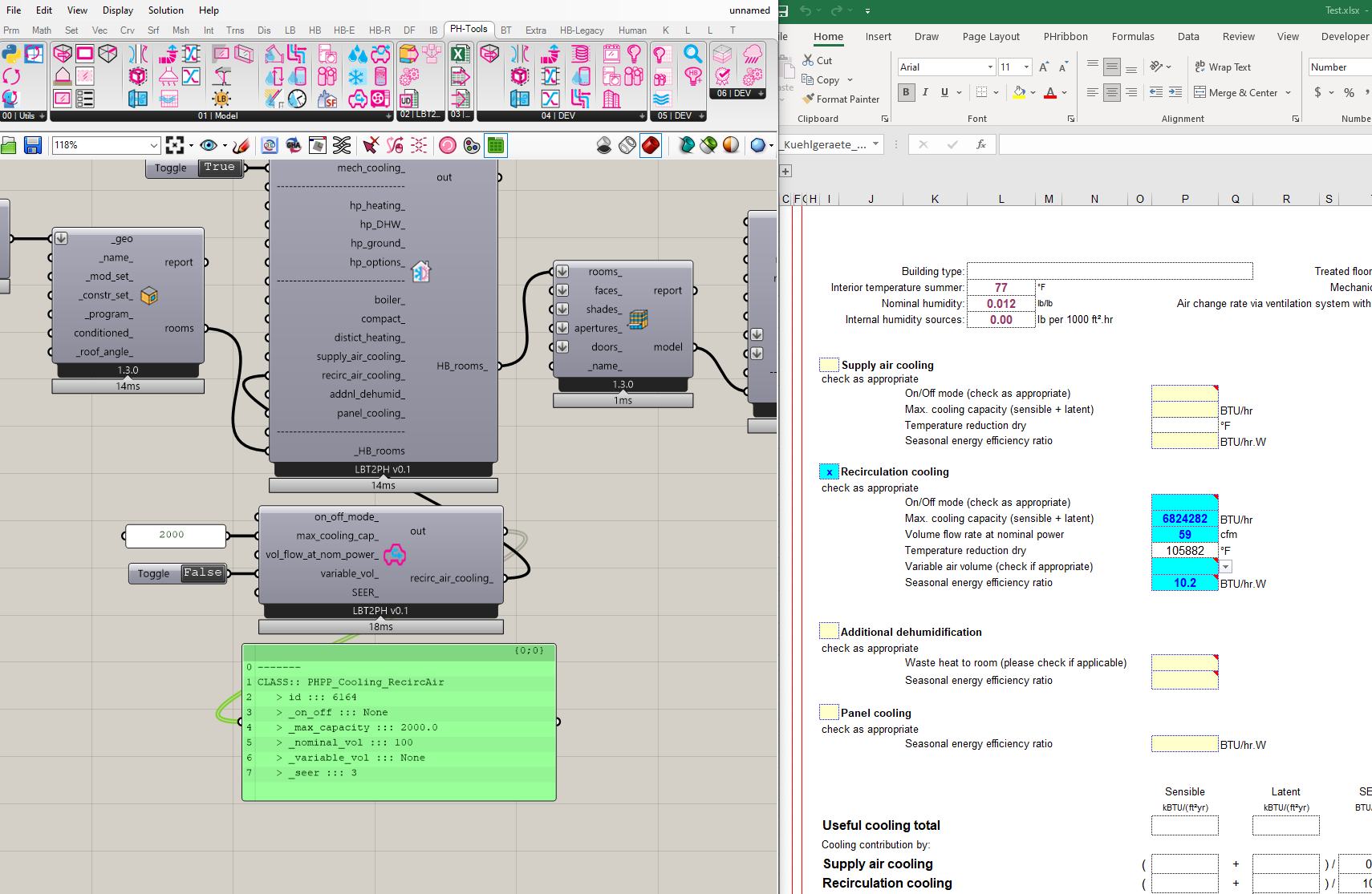

and with Variable Volume off:
