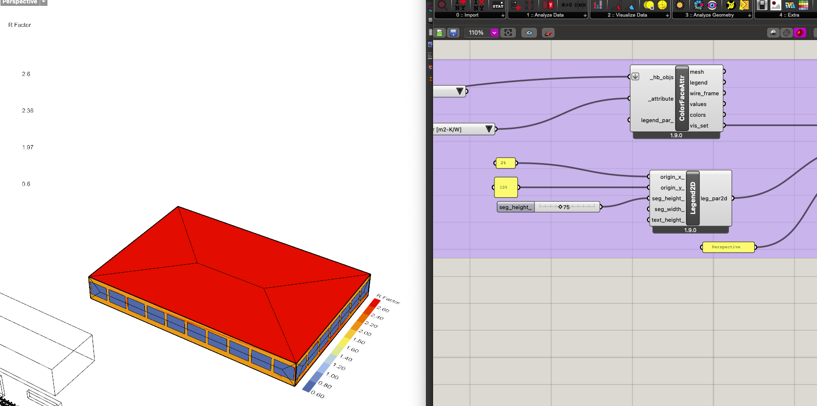

Colour gradient scale isnt appearing alongside the numerical values from my legend 2D parameters component. Does anyone have a solution for this?

You are on a Mac, aren’t you?
See here:
Hi @MichaelDonn ,
Sorry for the late response here. This definitely seems like it’s an issue for McNeel and so a post on their forum is probably going to be much more helpful than what I can offer. I can say that I was able to create the issue on my old 2017 MacBook running Mac OS 13.6.7:
[Screenshot 2024-07-25 at 4.55.14 PM]
I can also say that the specific part of RhinoCommon that is failing to render the legend correctly in this case is the DisplayPipeline.DrawSprite method. You can see t…
It is a bug in Rhino for Mac for which we are at the mercy of McNeel to address. So you can bring it up on the McNeel forum and see if they have any updates.

Here is the McNeel discussion for reference:
In July 2024 on the LadyBug Tools discourse Visualization Set preview on Apple Computers - #18 by MichaelDonn - ladybug-tools - Ladybug Tools | Forum I reported a difference between the display of legend in windows between Windows and Apple...
