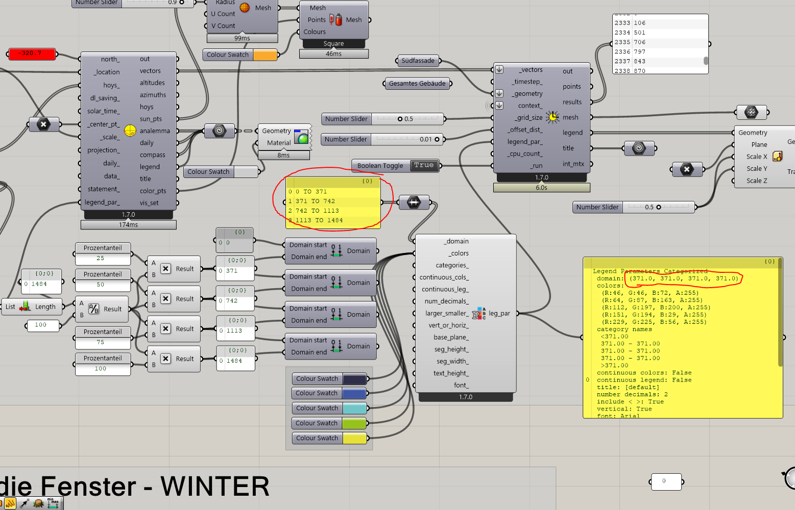

Dear people, I am trying to make my own legend in which I divide the data into number ranges (percentage ranges)! I have found the component ‘Legend Parameter Categorised’. Unfortunately I have problems to create the domains. No matter how I write it, it does not work. Even if I do it as described in the component.
A list of one or more numbers noting the boundaries of the data categories. For example, [100, 2000] creates three categories of (<100, 100-2000, >2000). Values must always be ordered from lowest to highest.
Don’t pass the input through the Domain component and just plug in a list like:
