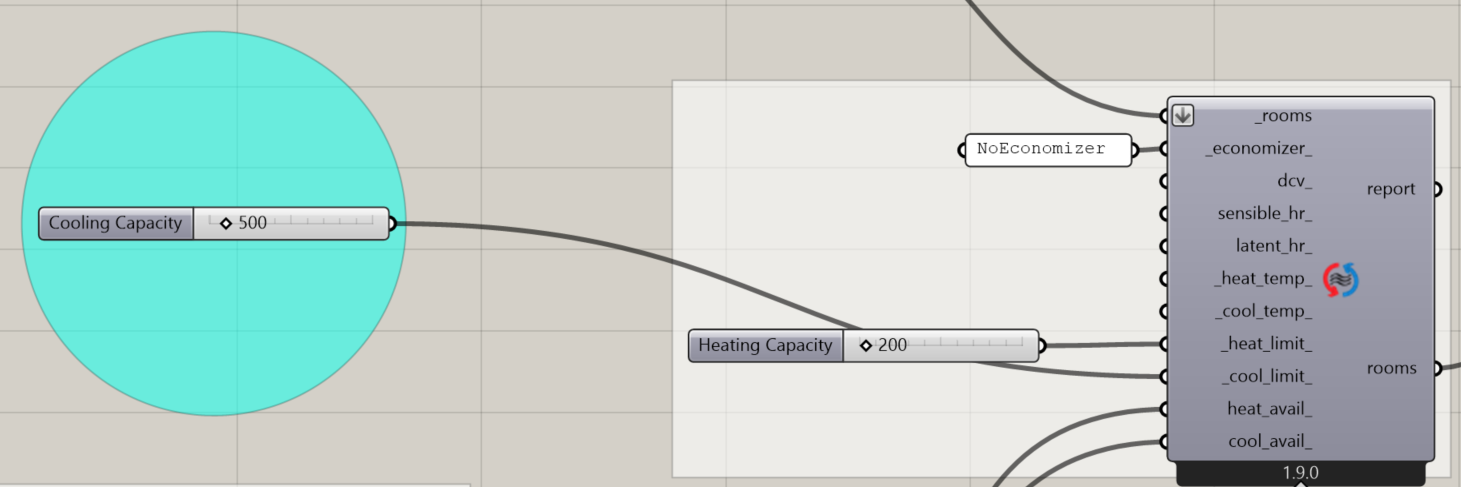

I am trying to use the Ideal Loads system setup to model a room which has fixed amount of cooling coming from ventilation. However, when I run my script, the capacity I set does not seem to have any effect on the results (e.g. 100W vs 2000W) of operative temperature.
Is there something I am missing here?

My aim it to specify capacity in the Ideal Loads node as here, but not sure if it works with any other parameter to take effect.

I am not sure if this is the issue here yet but there was a bug related to this that was fixed two weeks ago:
So I recommend updating to the LBT 1.10 release to see if this gives you the desired effect.
