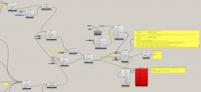

I’m new to Honeybee but have been pouring over the forums and YouTube tutorials and feel like I’m making good progress. Unfortuantely, I’m trying to run a HB LoadBalance but I continually get an error “Runtime error (ValueErrorException) : need more than 4 values to unpack”.
Can someone please help?
Here is an image, and my model is attached with internalised geometry. I installed Ladybug + Honeybee via Pollination, and I also updated all components today.
I thought the problem may be to be with my two rooms, but I’ve I remove one room (and the solve adjacency), it still presents the same error. Any suggestions?
energy_interalised.gh (194.3 KB)
I solved the issue, I had not connected a HB Read Face Result block!
