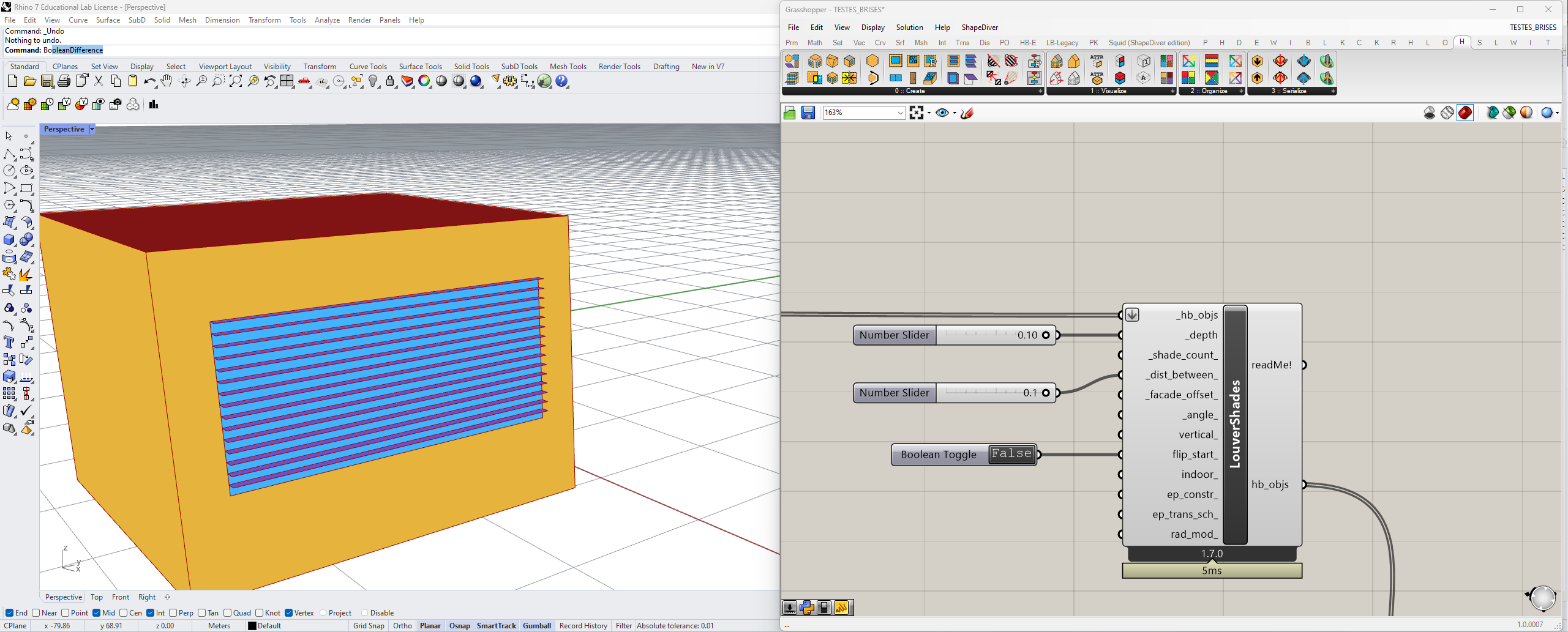

Hey!!! I’m trying to place Louvers Shades on a window and I saw that I have the option to choose to start from the top or bottom (in the case of horizontals). However, starting from the top (or bottom) does not create the last shade aligned with the window boundary. Is it possible to make this latest one?
Yes. Just make sure that the height of your window is evenly divisible by the _dist_between_ and you should get the last shade showing up at the bottom. If that does not work, you may need the window to be ever so slightly larger than the evenly divisible height (eg. 2.01 meters instead of 2.00 meters) because of how intersection tolerance works.
Thank you very much Chris. I’m sorry for taking so long to thank you. I managed to solve it the way you explained.
