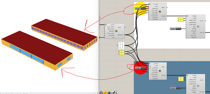

I think i’ve found a bug with the LouverShades component vertical option.
When the input is False the louvers should be horizontal and True they should be vertical. So far so good.

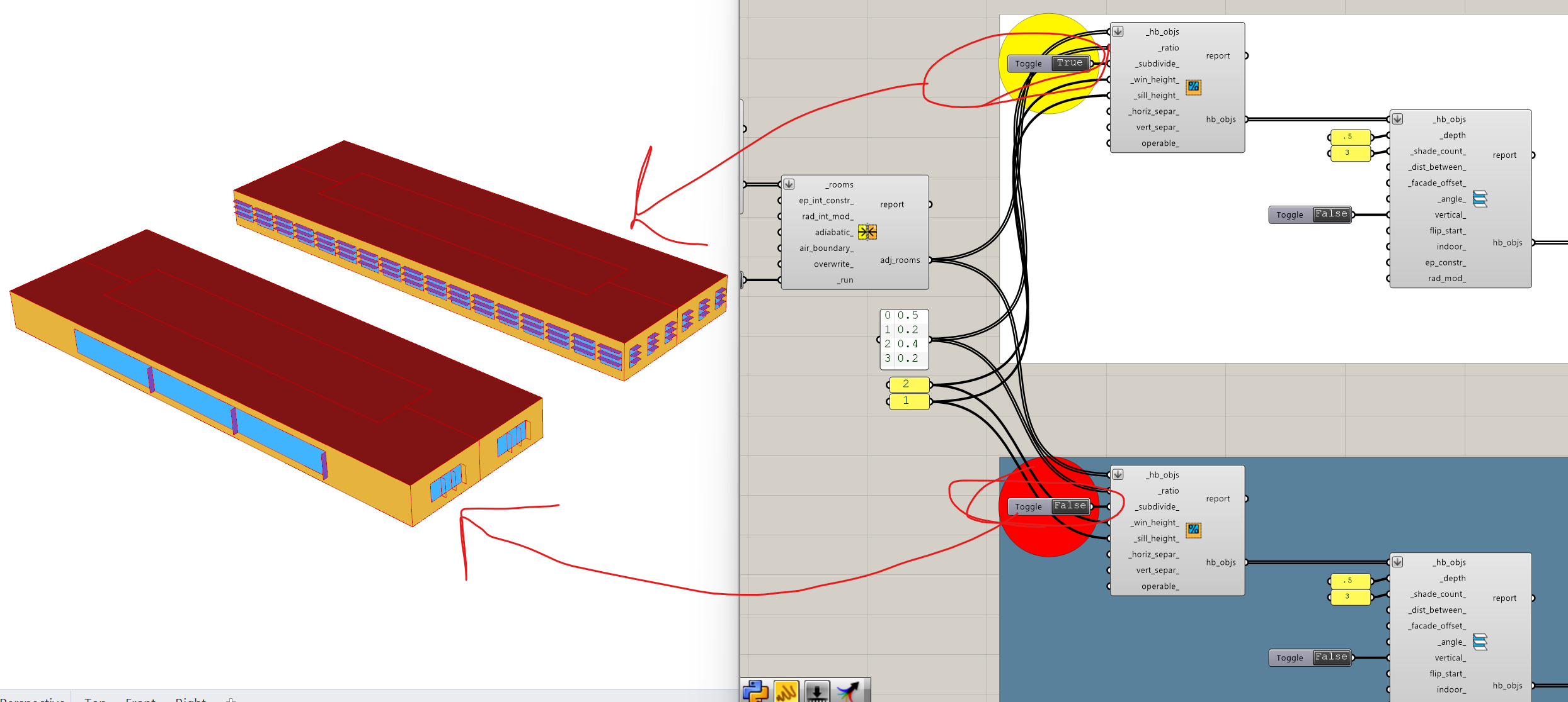

The issue appears when in the AperturesByRatio component the subdivide input is set to False. In such case the louvers flip orientation. The vertical become horizontal and vicsversa, like so:
Attached a simple file that shows the bug.
Thanks,
Louvers_Bug.gh (64.1 KB)
