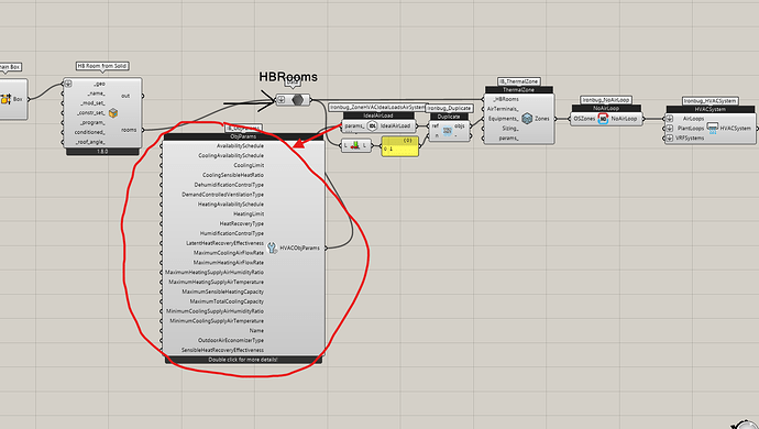

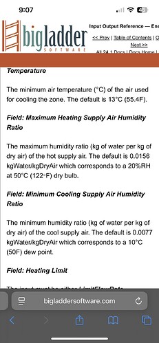

I noticed that the sample file IdealLoad sets these two parameters, which influence heating performance. However, Honeybee (HB) doesn’t offer a way to configure them.Does anyone know how to fix this? Thanks.
Hello, could anyone solve this? Plz!! Thank you!
@670 you can solve this with the ironbug ideal air loads template and use a params component on the ideal air loads component, it will give you lots of possible inputs

@670 no problem! let me know if an example file would help, here is a better image of the general workflow:

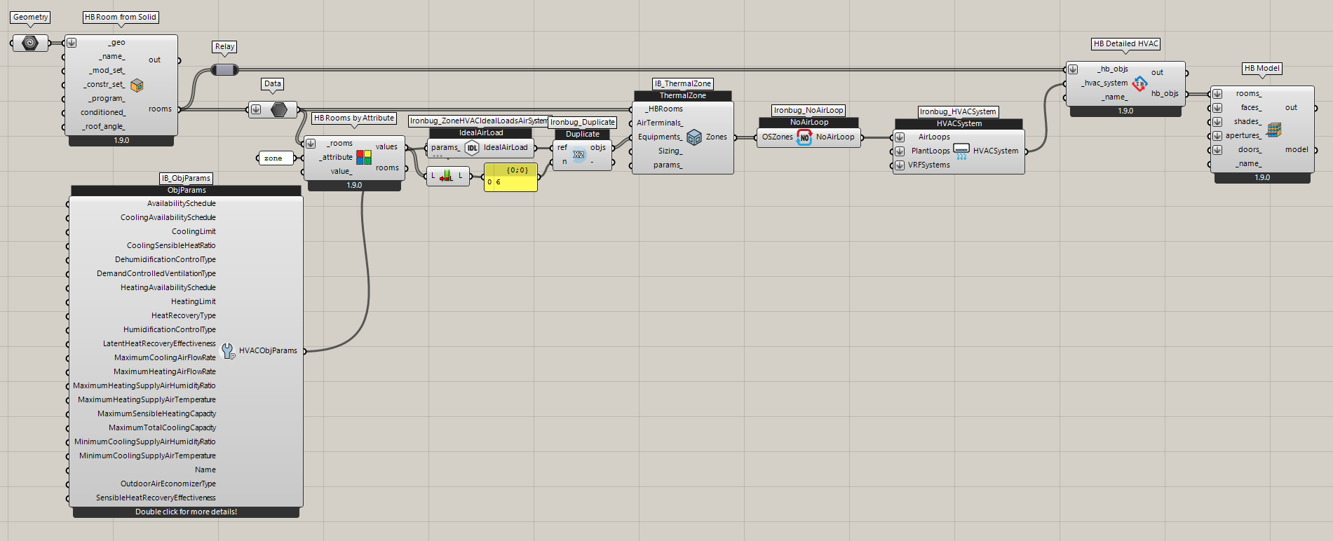

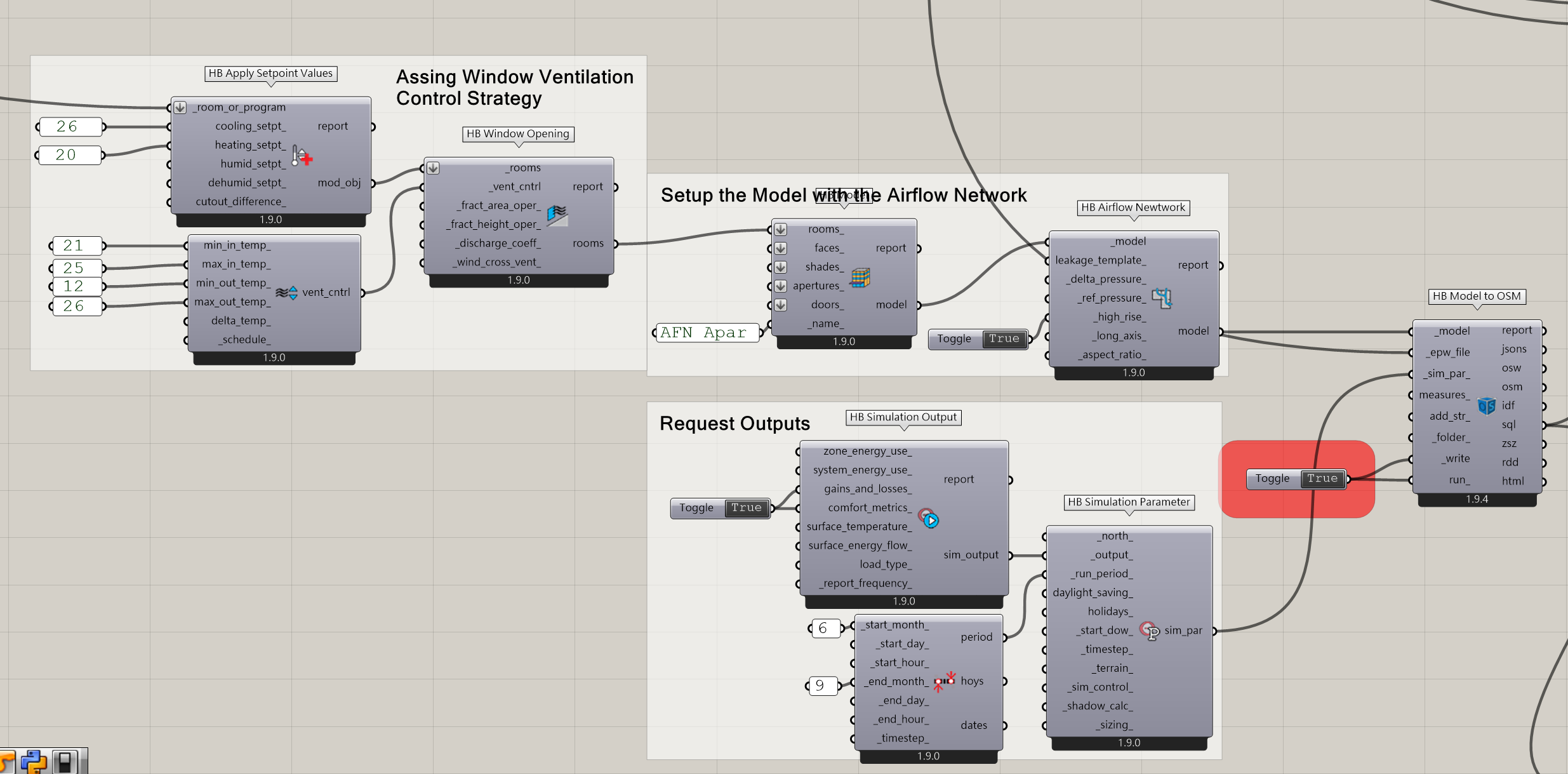

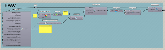

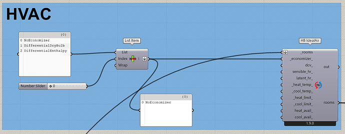

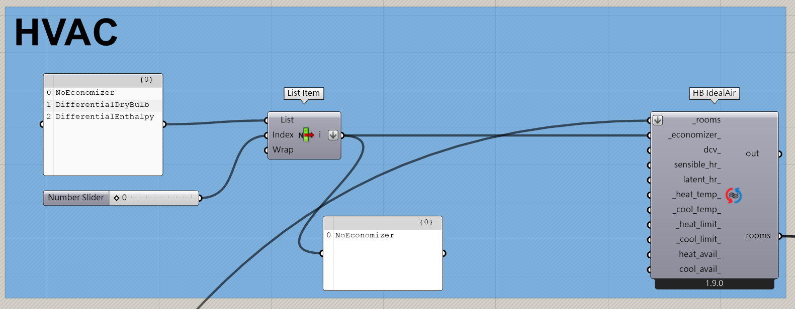

I am working on a mixed-mode simulation. My workflow works perfectly when using the native HB Ideal Air Loads. However, when I replace the HVAC with an Ironbug component (to simulate detailed HVAC ) and connect it to the HB Airflow Network, the simulation fails.
The HB Model to OSM component gives the following error: 1. Solution exception:Failed to translate Model to OpenStudio.
It seems like the AFN component conflicts with the Ironbug objects during translation. Is there a way to make them work together, or is Ironbug currently not compatible with the native AFN component?

(I have attached my screenshots below)
