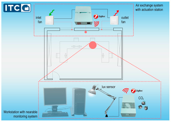

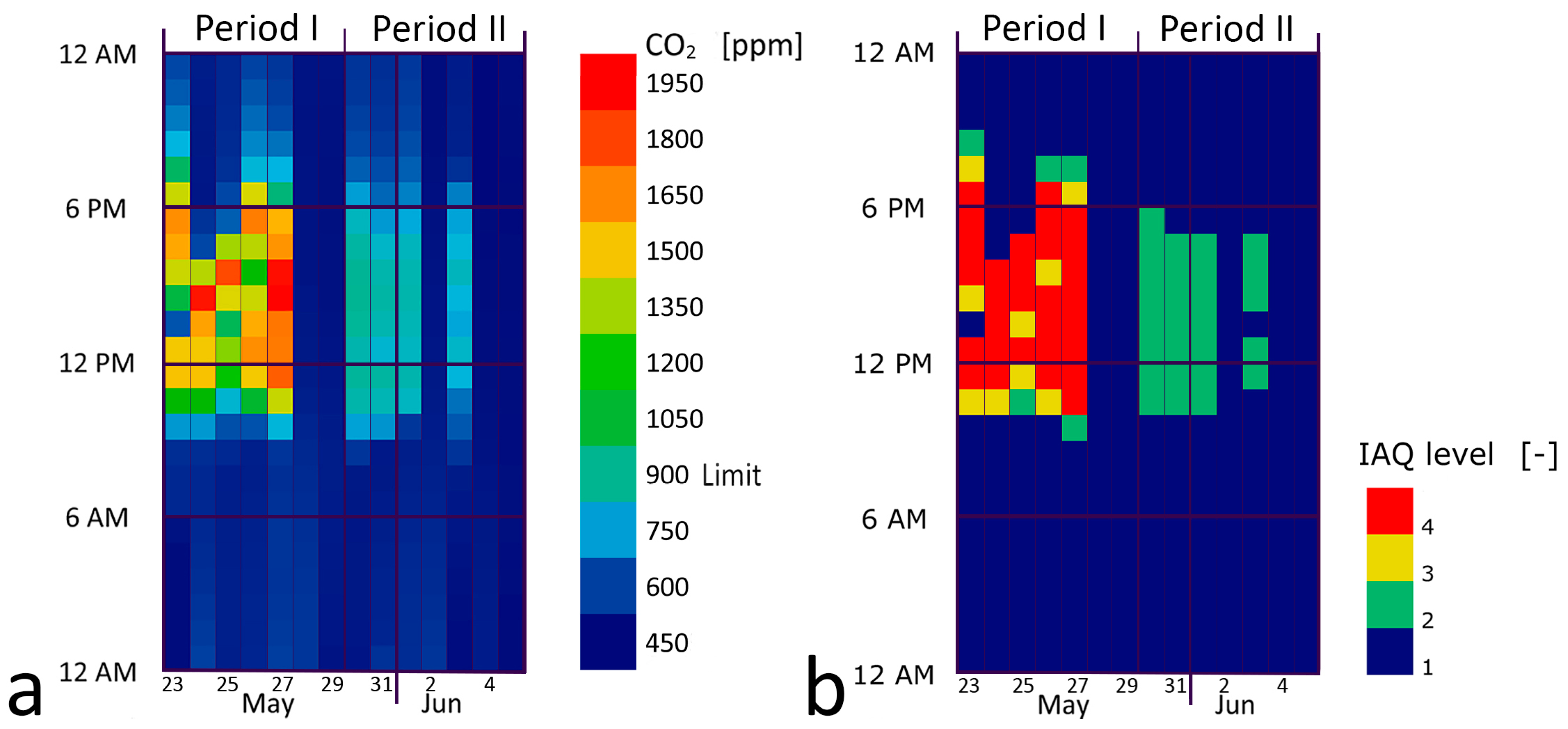

If you want to define the indoor CO2 concentration monitored by one or more sensors, you can consider the ladybug tools in order to realize something like this:
You can find more details here below:
I think @Francesco661 might have meant that you can visualize physical sensor measurements with the use of LBTs, at least that’s how I understand it.
To actually calculate CO2 concentrations with OF you’d need a set up that is currently not supported in BF.
Thank you @TheodorosGalanos for the clarification: I confirm that you can use LBTs to visualize physical sensor measurement but you can not use them to calculate CO2 concentrations with OF.

Which component did you use to monitor CO2 concentration and IAQ level?
