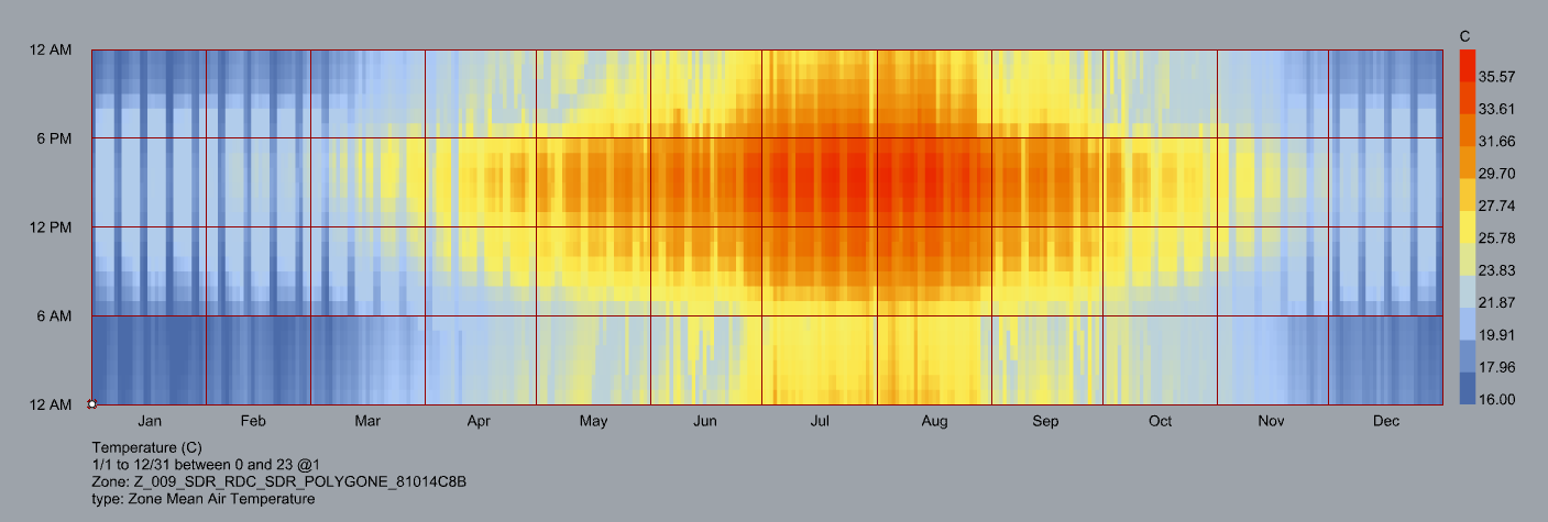

I want to simulate a night cooling with mechanical ventilation with HB fan ventilation component.

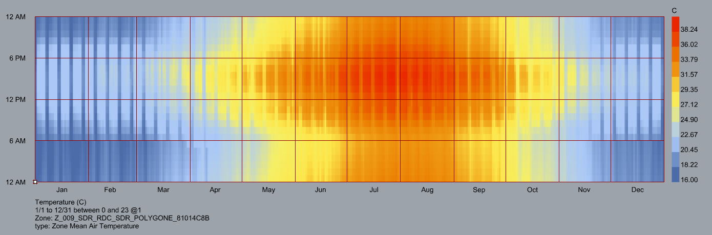

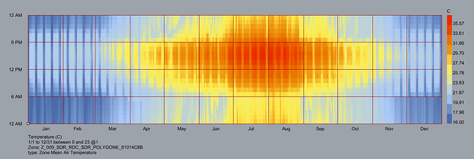

On the pictures below there is the annual temperature of a zone without and with mechanical ventilation night cooling.
So the night cooling is operational !

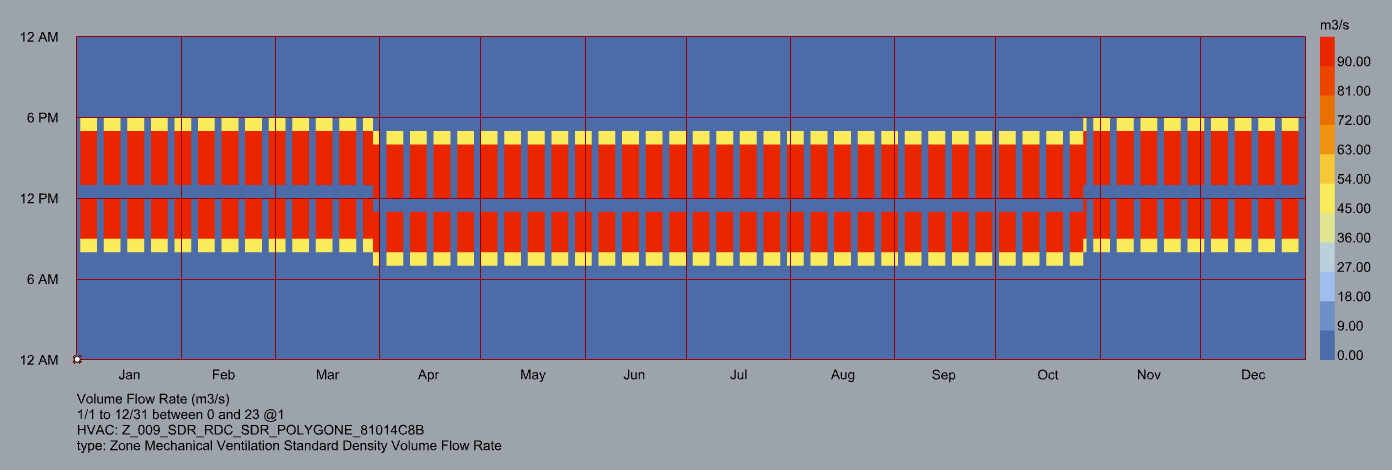

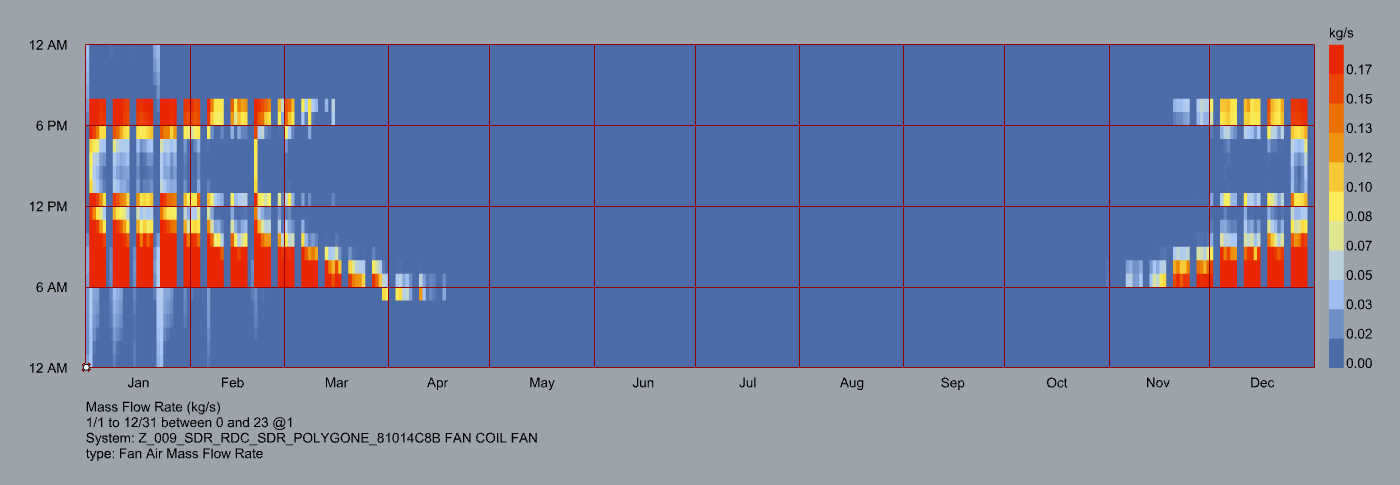

Here is my problem, I want to check the ventilation density volume flow rate of the night cooling but when I check the output “Zone Mechanical Ventilation Standard Density Volume Flow Rate”, I don’t have the night cooling but only the ventilation air flow from the component HB ventilation (so the day ventilation) (see picture below)

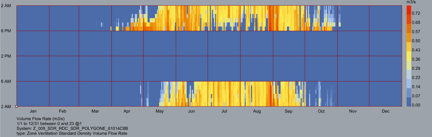

I also checked the output “Fan Air Mass Flow Rate” but I have this :
So it is not what I want. Where can I find the Volume flow rate of the mechanical night cooling ?

Hi @Geo

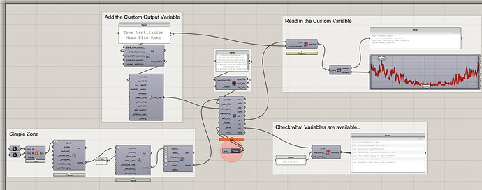

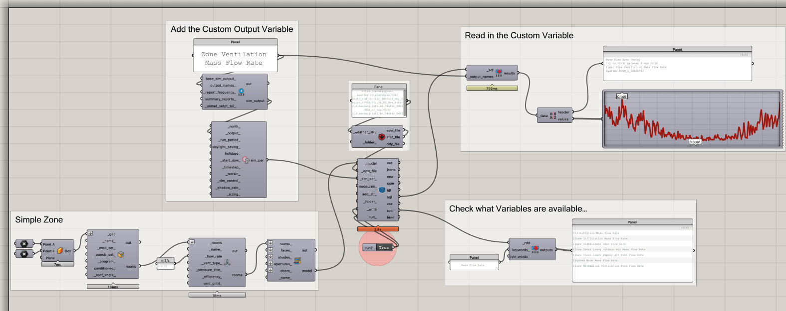

I don’t believe that HB-Energy outputs that information by default, but you can certainly add that Output-Variable and then read it using the ‘HB Read Custom Result’ component. So something like:
as the Fan component tooltip says, it is not part of the mech system, and so you won’t see its effect in ‘Zone Mechanical Ventilation’, but rather in the ‘Zone Ventilation’, I believe.
Example file:
best of luck with it.

Yes it is exactly that ! Thanks !
