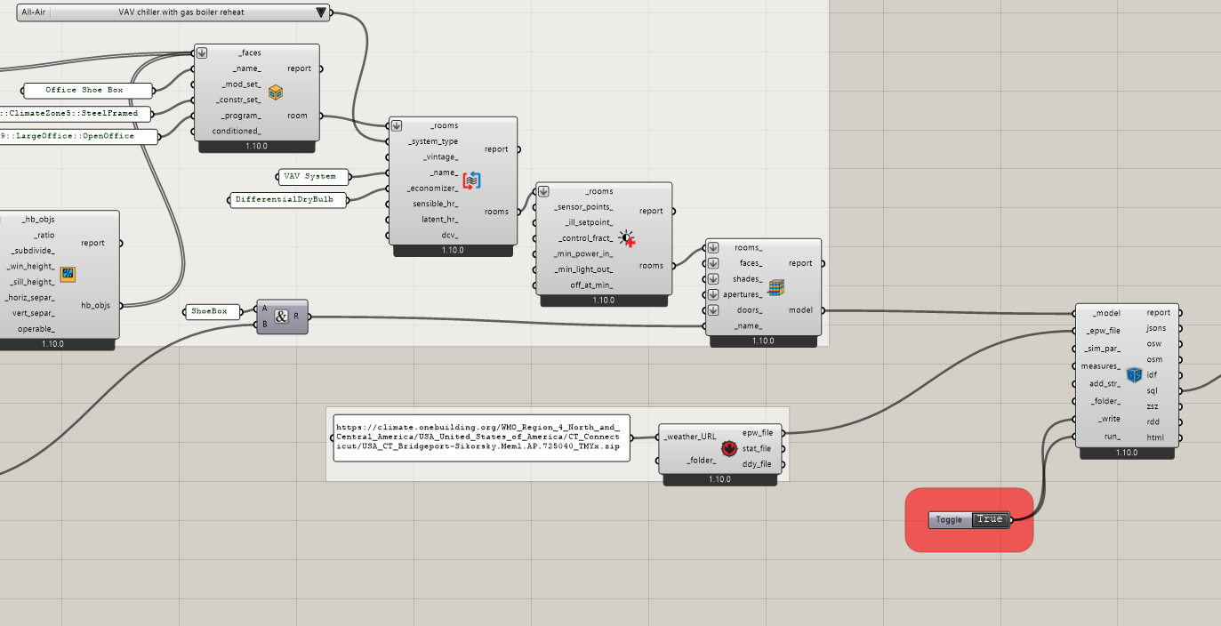

I cannot recreate this issue. I used the following script to simulate a shoe obx with this energy model:
test_ASHRAE_Tau.gh (53.9 KB)

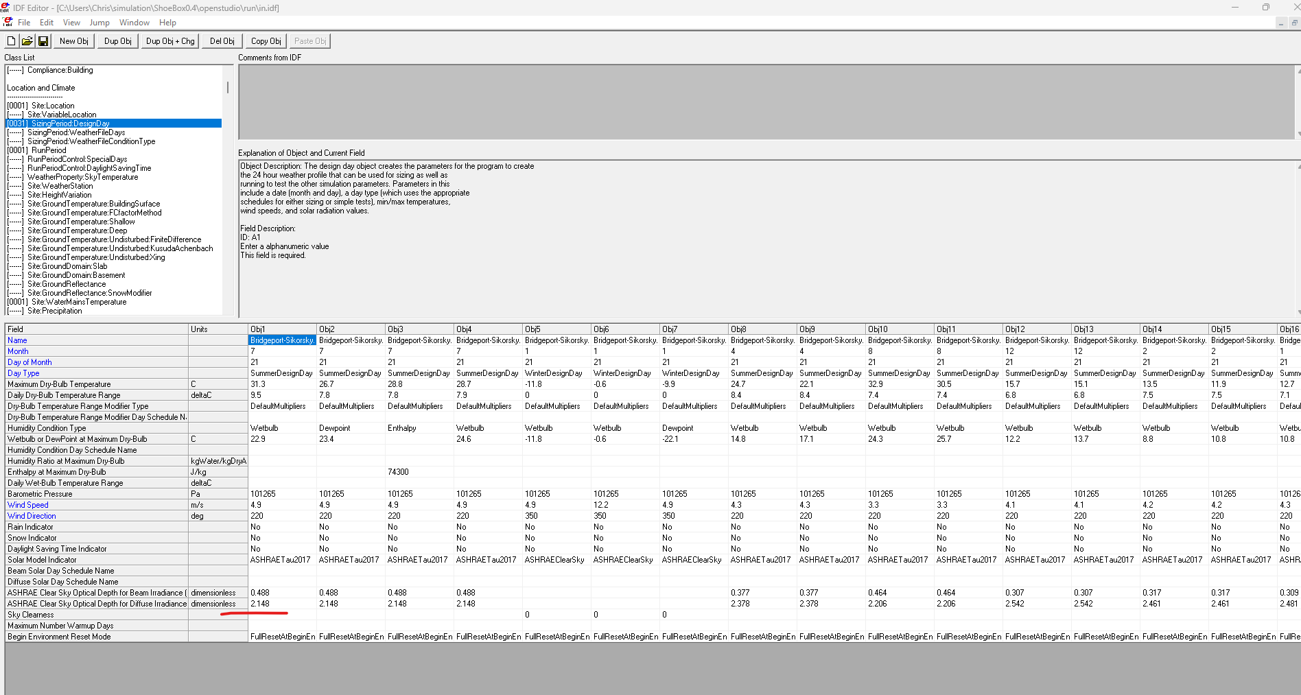

… and the resulting IDF clearly has that tau values in it:
If anyone else is able to recreate the issue, please upload a sample .gh file and I can take a look.
