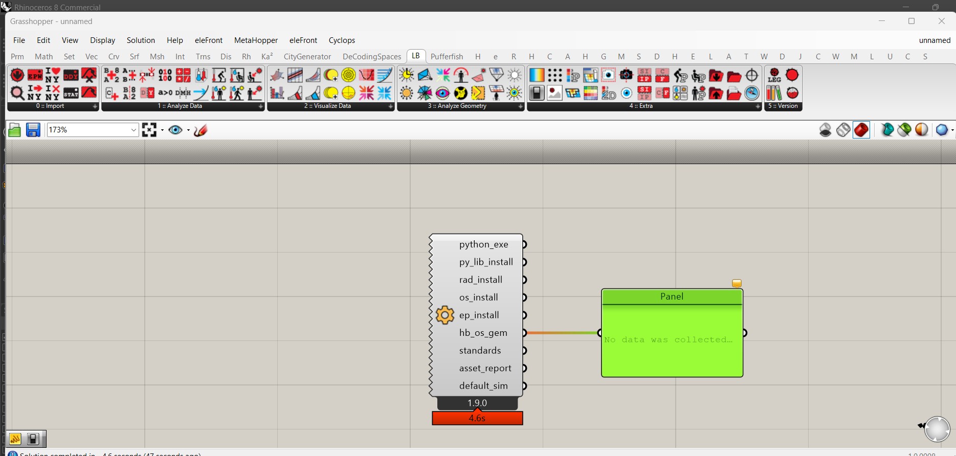

Hello, I am having an error in running dragonfly component (DF Run URBANopt) since updating LBT 1.9. The error is: 1. Solution exception:No URBANopt Gemfile was found in dragonfly_energy.config.folders.
This file must exist to run URBANopt.

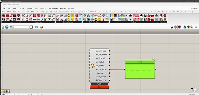

I realized that gems are not present as shown in the screenshot.
How can I solve this problem as I re-installed Ladybug from food4rhino, and I also used LB versioner, but with no success.
