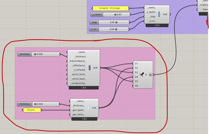

Hello, I try to modelise R128 house in ladybug but i have a problem.
This house is entirely glazed and the part of “wall” represents approximately 1% of the facades only when I modify the conductivity of the wall material which represents 1%, I divide it by 10 for example, well I divide my annual heating consumption by 10 whereas when I divide the conductivity of the glazing which represents 99% of the facades by 10 well I lower my heating consumption very little…
r128.gh (206.2 KB)
works with that :
r128-2.gh (217.9 KB)
