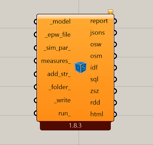

The pollination installer is working correctly and OpenStudio comes with a compatible version of E+ so there will never be a version conflict there. The problem happens because you are using an old Grasshopper script with an old “Model to OSM” component in it, which is not compatible with the latest pollination/LBT-Grasshopper version.
I suggest running the LB Sync Grasshopper File with your old Grasshopper definition so that it will be synchronized with the components you have currently installed. If everything has run successfully, you’ll see that the “Model to OSM” component should be 1.8.3:

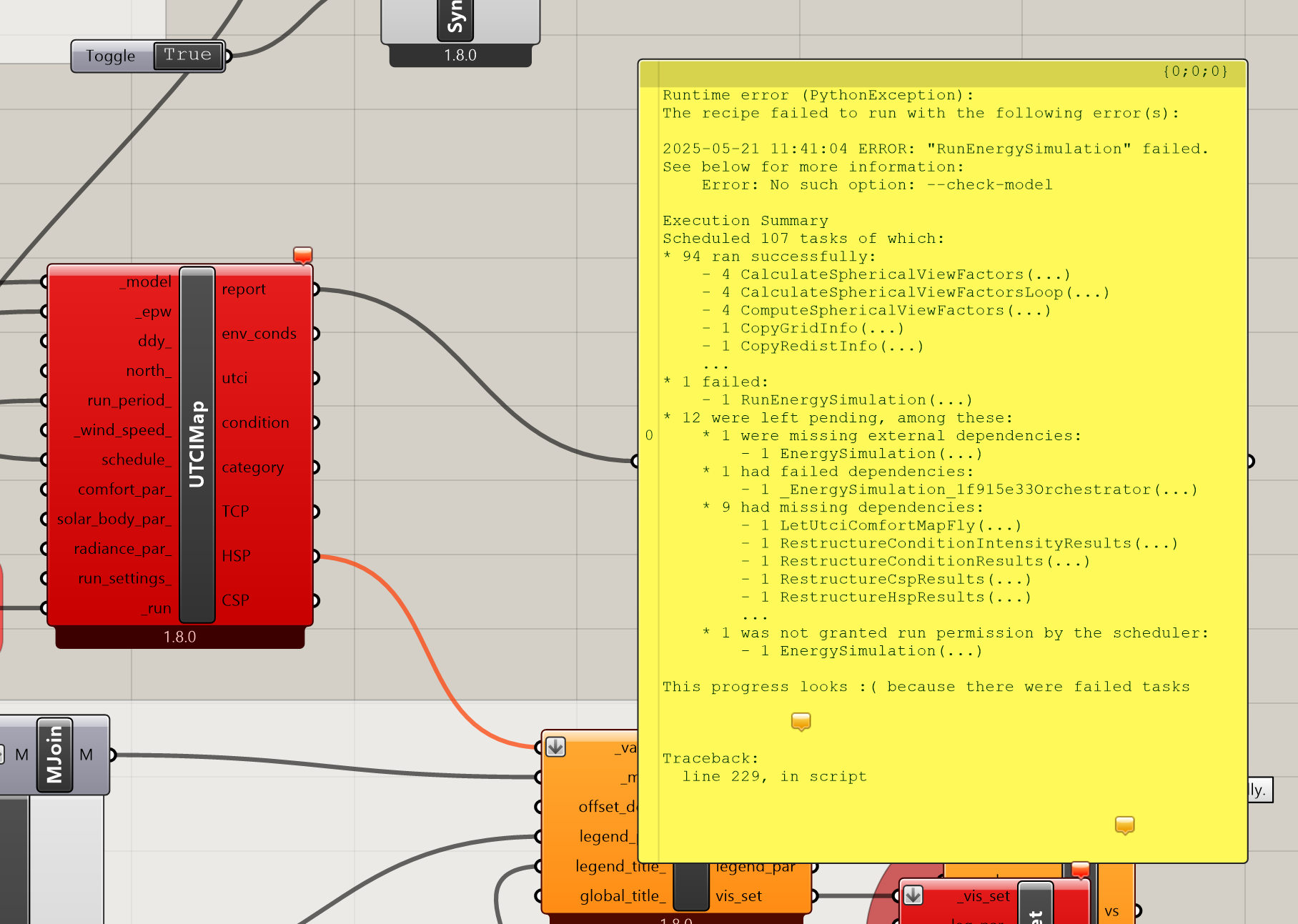

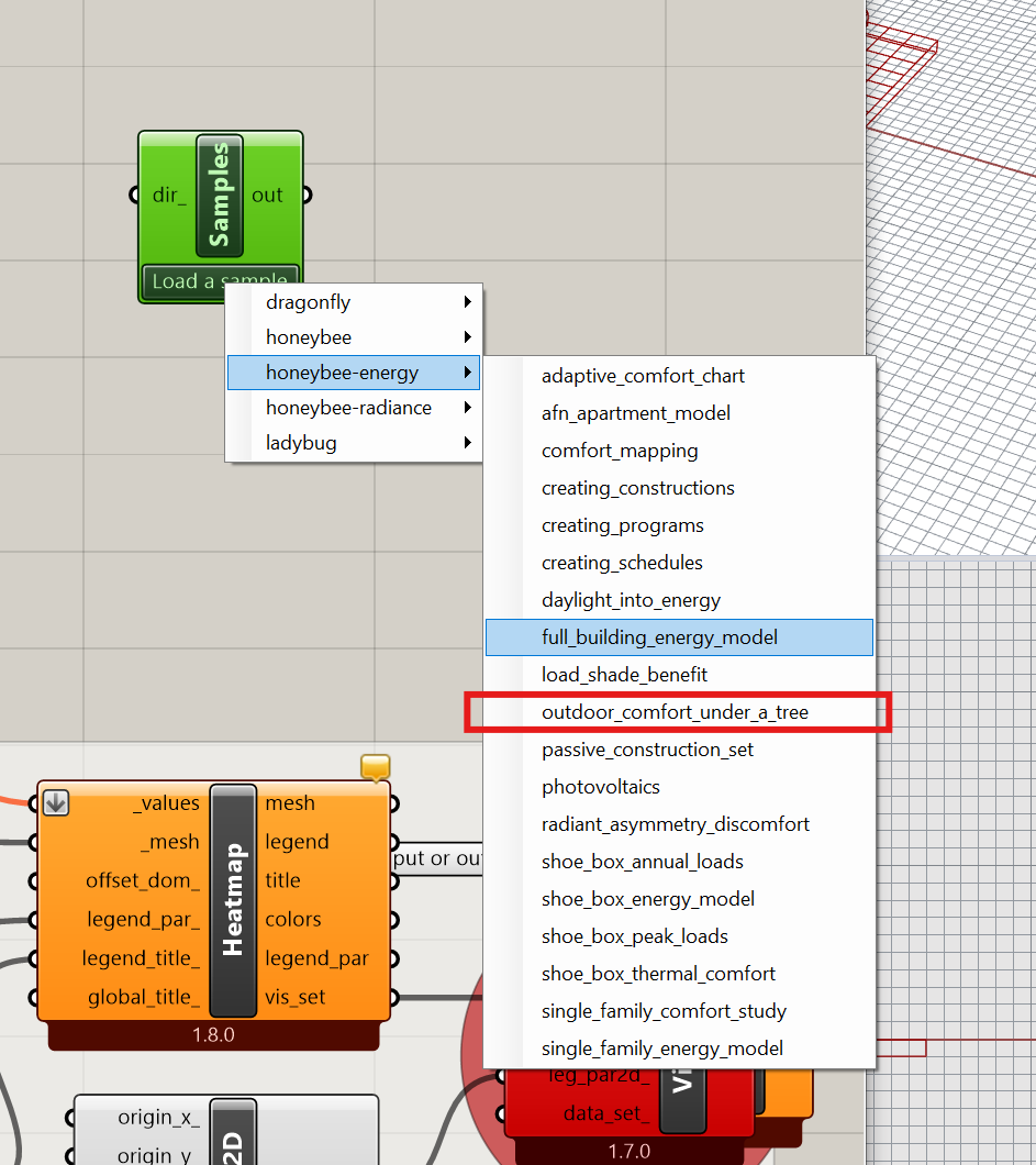

Hi @chris !! Thanks for responding so quickly, This did work for ModelOSM!! However, when I run the sample script “outdoor_comfort_under_a_tree”
I get this error, even after syncing the file?
Yes, there was a bug that @Byron reported today and I fixed a couple of hours ago:
You can get the fix on your end now by running the LB Versioner component.
Amazing!! I just ran versioner and it works now!! Thanks @chris!!
