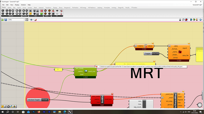

I am having an issue with extracting hourly MRT results from a UTCI Comfort Map simulation in Grasshopper.
I have two models:
  • A baseline model
  • A Scenario01 model, in which I have only changed the material properties
The UTCI simulation runs successfully for both models.
For the baseline model, I can extract and convert the hourly MRT results without any issue. However, when I use the same workflow for Scenario01, I receive the following error:
Solution exception: Could not find file 'C:\Users\User\simulation\unnamed\utci_comfort_map\initial_results\conditions\final\mrt\results_info.json'.
Therefore, the issue is not that the UTCI simulation fails. The UTCI results are generated successfully for both the baseline and scenario models. The problem occurs only when I try to read or convert the MRT results for Scenario01.
It appears that the following file is either not generated or cannot be found for the scenario model:
The same MRT extraction/conversion workflow works correctly for the baseline model.
I am currently using Ladybug Tools version 1.10. I previously used version 1.8 on another computer, where the MRT results could be exported directly to Excel without this issue.
I have attached both Grasshopper files so that the baseline and scenario workflows can be compared.
Does anyone know why the MRT results_info.json file may be missing only for the scenario model, even though the UTCI simulation completes successfully?
Could this be related to:
  • The changed material properties
  • Cached or overwritten simulation results
  • The simulation folder structure
  • A difference between Ladybug Tools versions 1.8 and 1.10
  • A missing MRT result output in the scenario simulation
