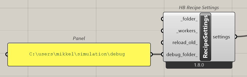

You can set the number of workers in HB Recipe Settings.
If you have 8 workers it will split the sensor grid or image into 8 equal parts and run them simultaneously. When they have finished the results will be merged into one sensor grid or one image.

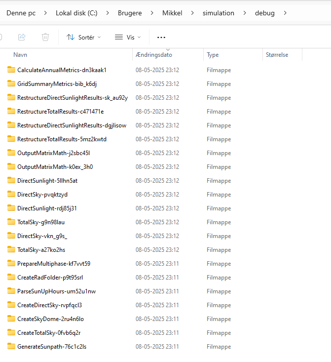

You can add a debug folder in HB Recipe Settings. In this folder you will be able to see all the steps of the recipe. In each folder there is a batch file with a CLI command.
