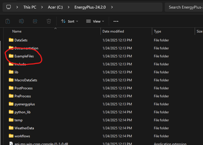

Hi @quentin! The way I would go about it is via an EMS routine input via the _add_str_ input on the simulation component, there are some sample EMS files as well as PyEMS within the energyplus installation.
Here is the link to the ems documentation
hopefully that is helpful and not more confusing!
also chatgpt can be helpful in creating these ems scripts but be very weary, double check everything and explicitly ask it to check against 24.2 idd file to help make the script accurate
