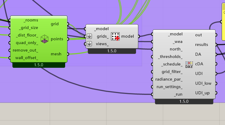

I ran into a problem. I used the HB Radius component to calculate the annual illuminance, but it was nega
tive. Why
屏幕截图 2022-10-17 215356
Hi @tangtang,
Have you tried to increase the Radiance parameters with the HB Radiance Parameter component?
I tried to add the HB Radiance Parameter, but there are still negative illuminance values, which are a little less than the negative values without adding the HB Radiance Parameter. How can I set it so that there are no negative values,
21d1ad5a7582ede05e737b318113a86
Hi @tangtang,
The parameter settings you have on your image usually should do it. Are you able to share your Grasshopper file?
LBT10.30.gh (578.0 KB)
Yes, could you please check what’s wrong
