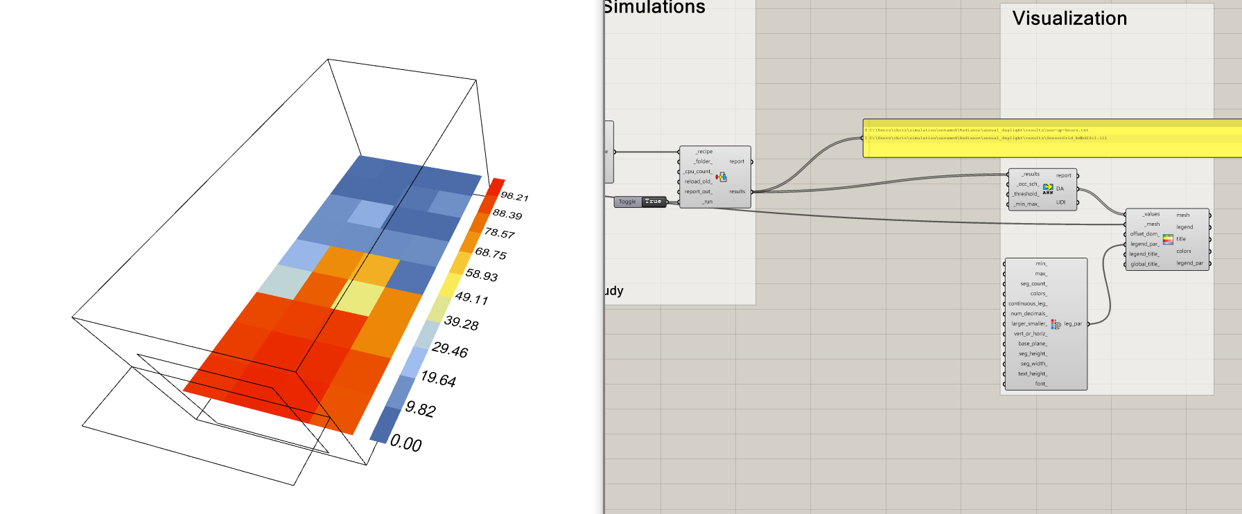

@jakechevrier ,
It worked for me:
Did you recently run the “LB Versioner” component? @Mostapha recently introduced a bug in the annual daylight recipe on the development version of the plugin. So, if you want to run annual daylight, you should make sure you’re using the stable release - 1.0.9.
But Mostapha should be working on a fix now. So the development version will be fixed soon enough:
FYI @mostapha pushed a fix into the development version of the plugin yesterday:
I can confirm that I am able to run your file with the latest development copy of the plugin.
