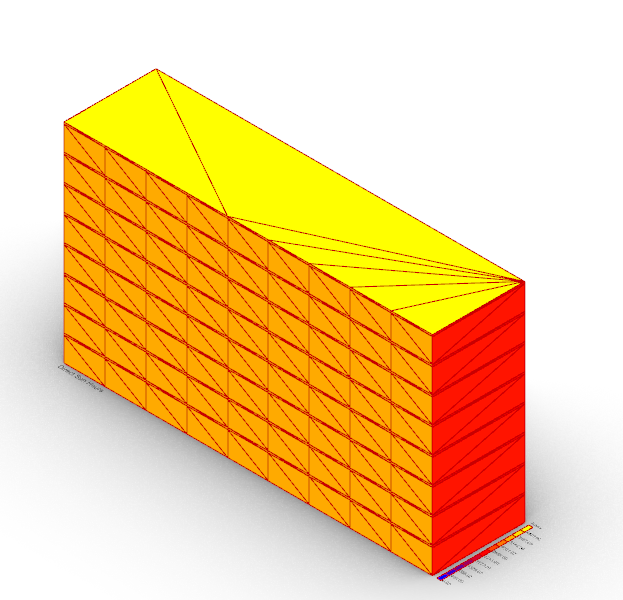

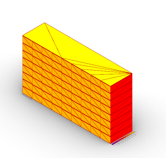

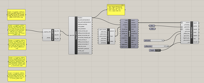

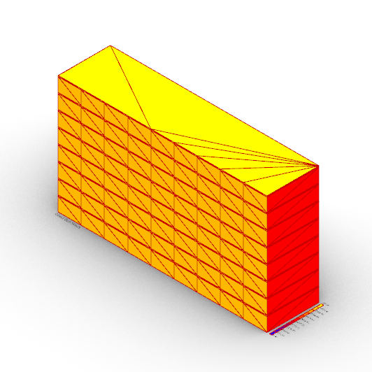

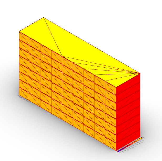

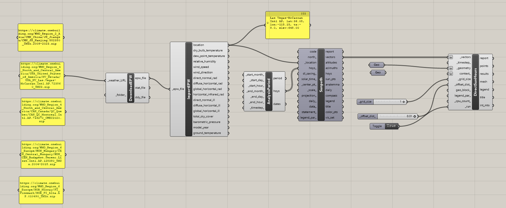

I need some help. I am trying to do an analisys on a building’s facade yearly sun hours using Direct sun hours in grasshopper depending on different locations: Nanjing in China, Las Vegas, Montreal and Budapest. The problem is that i get the same results for all the locations, only changing the legend in 3-5 hours yearly in every location. I modeled my building in sketchup and imported it into rhino. I am using links to climate.onebuilding.org for the epw.
Any ideas, insights, and thoughts will be very helpful.
Thank you.
Welcome to the forum @Marina_Carrera_Toca ,
Hard to say from the images but the first thing I would check is the scale of the legends. My bet is that they are different from each other. You can set a legend_par input to have them all on the same scale
