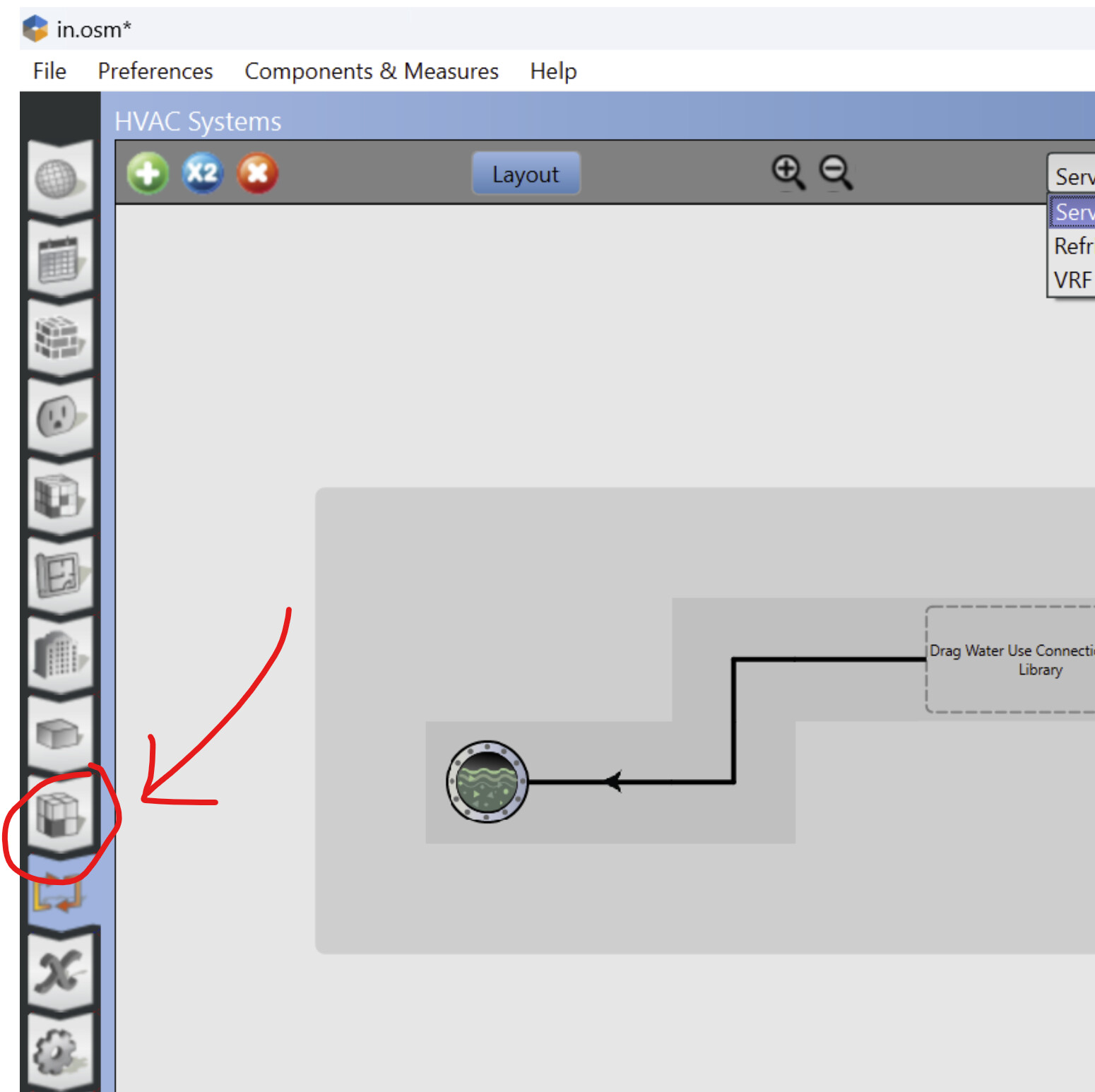

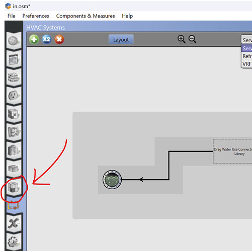

Hi @behnammmohseni
PTHP is a zone equipment, you can find it under the ThermalZone tab of OpenStudio App.
