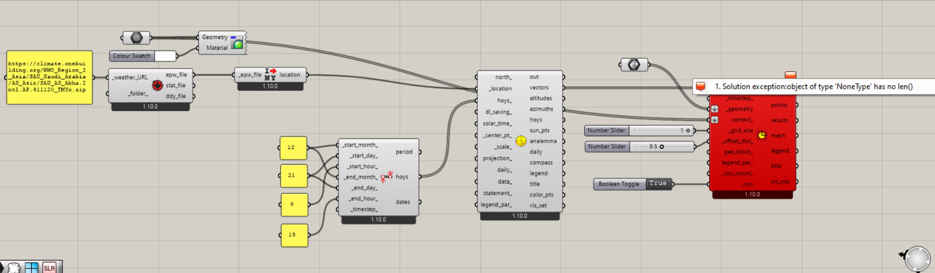

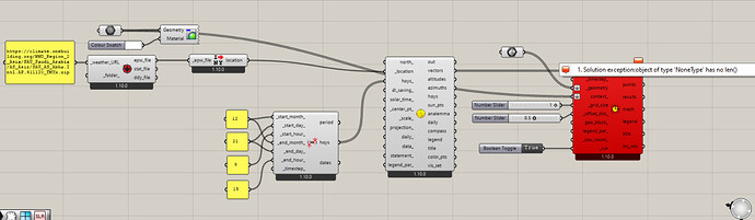

im trying to use LB Direct Sun Hours on my project, while im creating Brep to identify mu building (all surfaces)
it give this error “Object of type ‘Nonetype’ has no len()”
Check if all geometry inputs are indeed geometry [not Null items].
I would try Abraham’s suggestion first. Thinking out loud, this type of message could also happen if you accidentally right-clicked a component input and changed it to “Item Access” instead of “List Access.” So, to be sure, maybe just drag and drop a new component on your canvas to see if you get the same exception message from it.
If neither of those fix it, then it could be a bug or at least a case that merits a clearer exception message about what is wrong about the inputs. So feel free to upload a sample file that recreates the issue and I’ll have a look.
