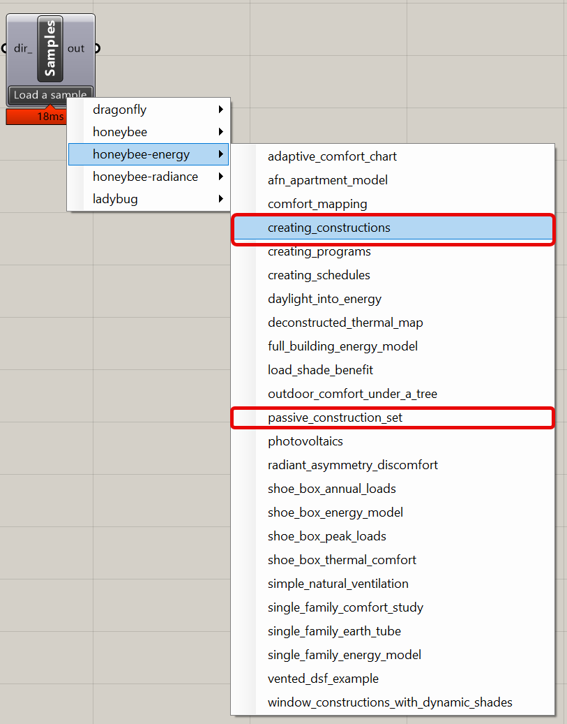

This may be appropriately placed elsewhere - it relates to the constructions sample file distributed with v1.9. Just checking moving week 2 tutorials to constructions and programs.
Starting with constructions(first highlighted option):

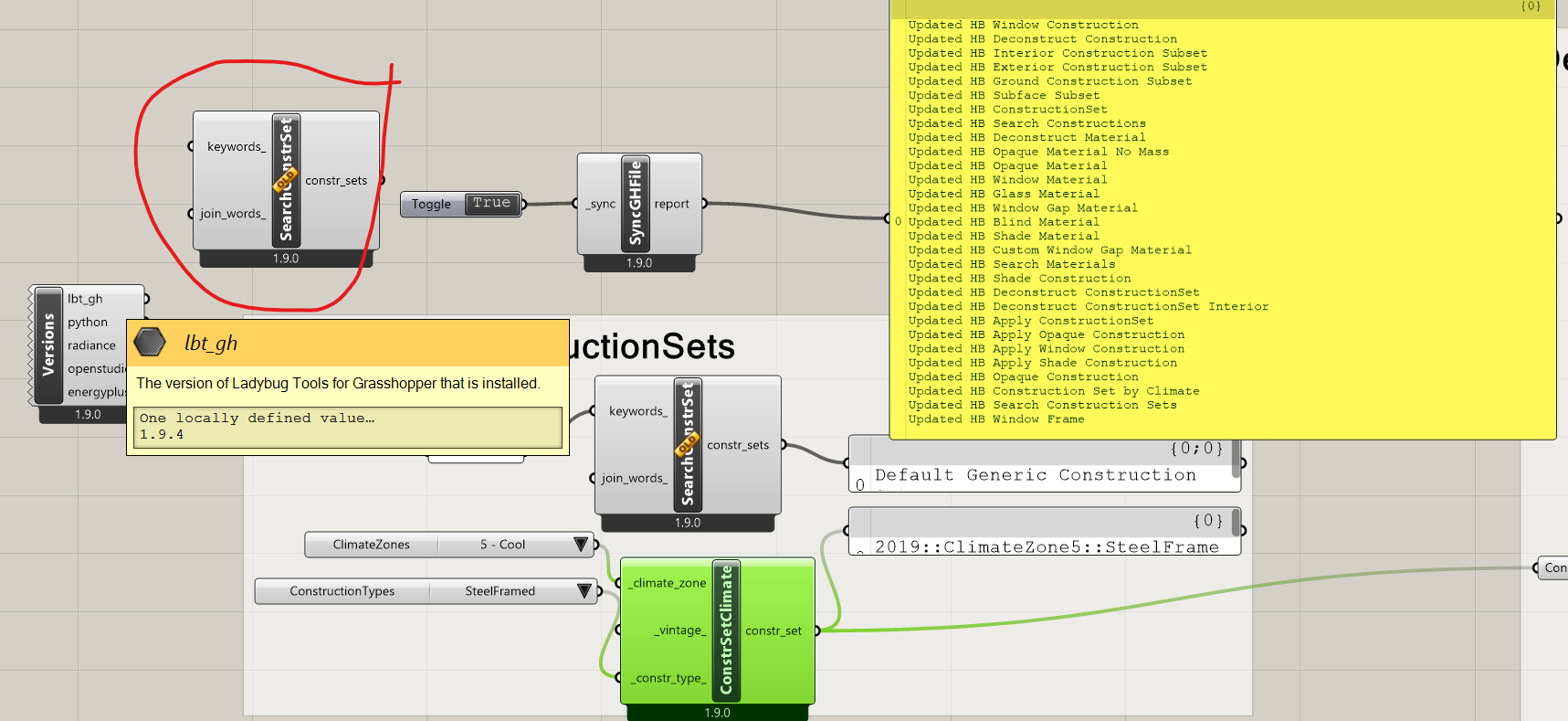

I find I have the following component with an label in the sample, and even when I add the component from the <Honeybee Energy 0> menu, I still have the label (that is why the two identical components)
If I run the version updater, I get the same issue.

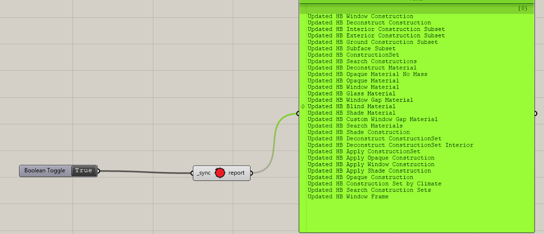

@MichaelDonn You need to first apply the LB Sync Grasshopper file, as shown in the pictures below, it will updates the components inside your canvas (pulled from any repo or opened from previous files), if there is component that has a problem in automatic updates, it becomes red and which tells you to replaced it manually.
After the applying LB Sync Grasshopper file, if there is an old Logo on it without red flag for a component, the component is fine and is working.

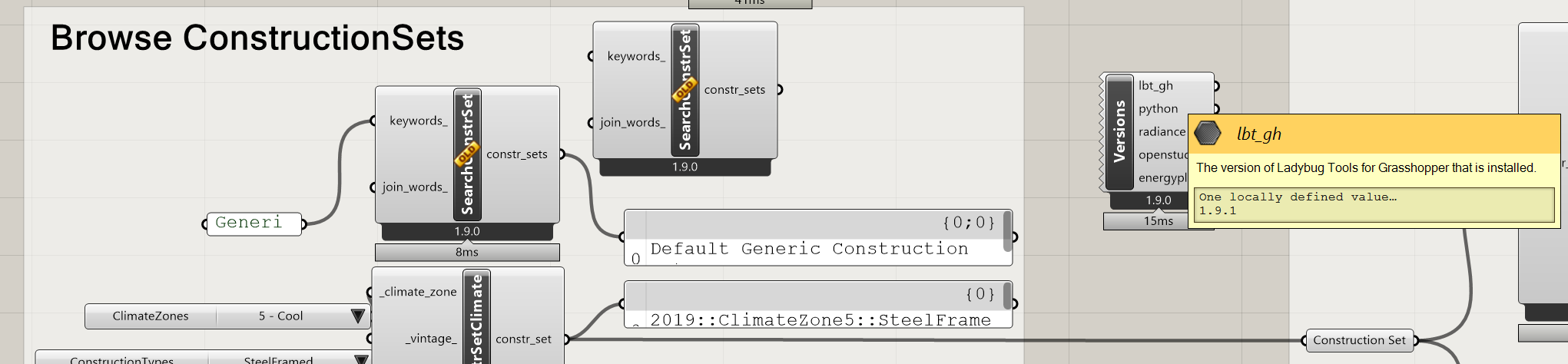

First I tried dropping the latest component from the newly updated LBT v9.1 onto the canvas - that revealed this label

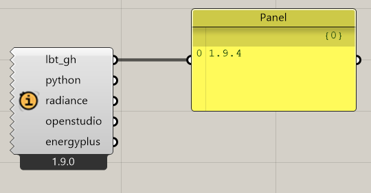

Second, I updated the version of LBT (1.9.4 already) and “created” the new construction sample file - same label

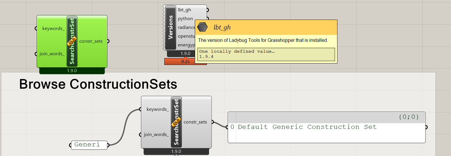

Third, I dropped the component from the new v1.9.4 menus (highlighted) onto the canvas - same label
Fourth, just for completeness I ran your suggested operation on the sample script - same label

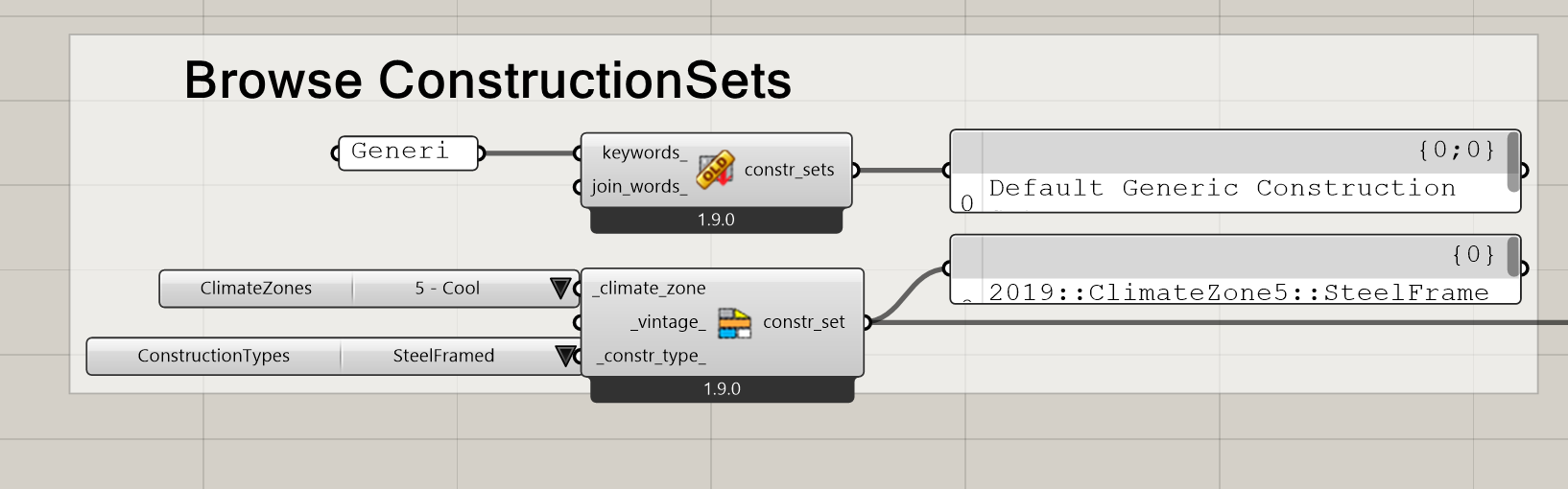

I’ve found this a while ago [the “old” label] on this only component [search constructions set].
