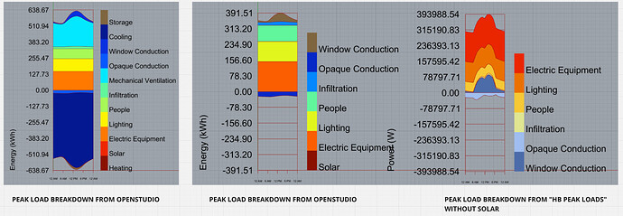

Seems the peak load difference between “HB Peak Loads” and Openstudio is because of solar gain load.
As below graph shows, it is unable to get the solar load for sizing day, but the annual energy balance has solar gain.
And the peak loads from openstudio is very similar with the one from “HB Peak Loads” without solar gain load
May I know if it is some bug with openstudio? or I didn’t setup the HB script properly?
