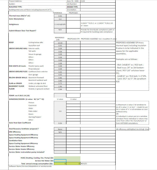

Here is a sample of what the city is looking for from a data standpoint.
