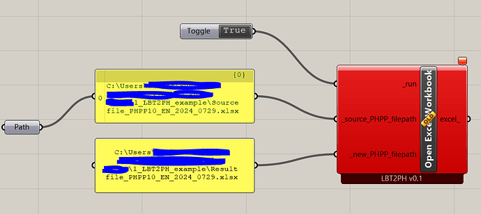

I’m having difficulty opening an Excel file by providing a link using PH-tools
The programs I am using are RH8 and PHPP V10.4.
First - I’m concerned because “OLD” is written next to “Open Excel workbook.”
Second - When trying to open the Excel file, it shows an error: “1. Solution exception: ‘Microsoft.Office.Interop.Excel’ object has no attribute ‘ApplicationClass’.”
I copied the Microsoft.Office.Interop.Excel file into the script RH8 folder.
I tried various ways to solve it, I changed the interop Excel file in the script map, I changed the Path. I don’t understand the reason for the error."

Hello @Ervins ,
It looks from the screenshot there that you have the LBT2PH components. Those components are not supported anymore and do not work (as far as I know) with Rhino 8.

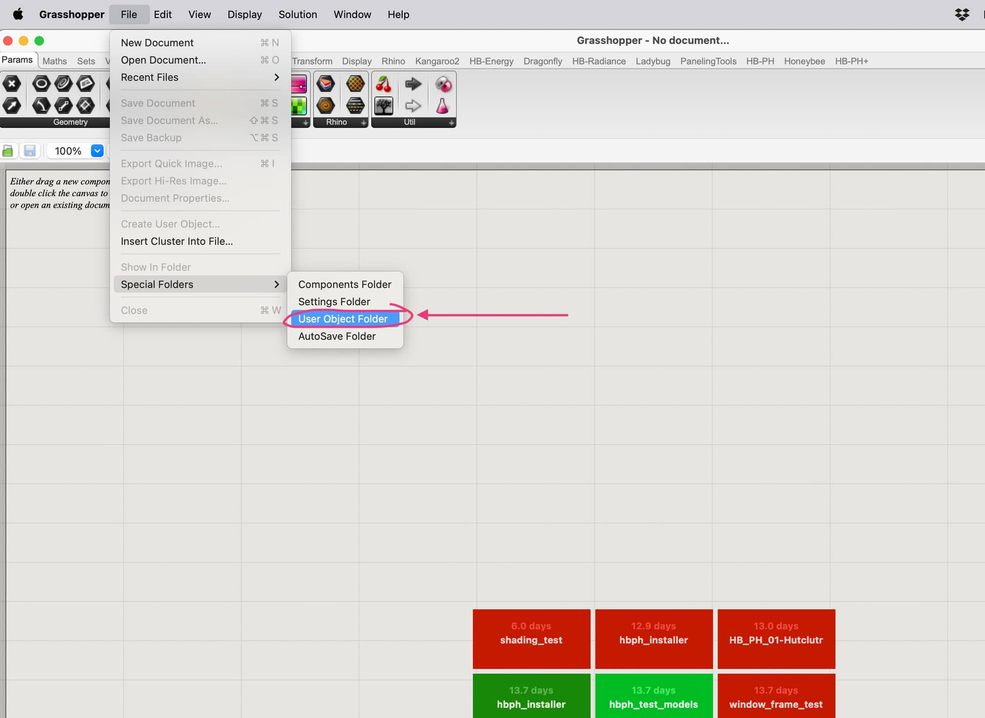

For all PHPP related work, the up-to-date plugin is the “Honeybee-PH” plugin. You can download the free installer here:
I would suggest going to your Grasshopper ‘User Objects’ first and deleting all of those old ‘LBT2PH’ components before you install this new "Honeybee-PH’ package.
Hopefully that new and updated pluing works for you?
