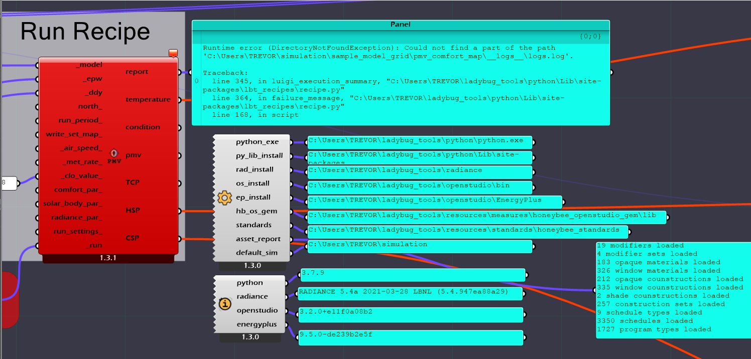

PMV map 1.3.1 errors (DirectoryNotFoundException): Could not find a part of the path
Haven’t ran these in a bit: using most up to date install: Also using OS 3.3.0; most up to date version of other dependencies as well
Runtime error (DirectoryNotFoundException): Could not find a part of the path 'C:\comfosims\pmv_comfort_map\__logs__\logs.log'.
Traceback:
  line 353, in luigi_execution_summary, "C:\Users\TREVOR\ladybug_tools\python\Lib\site-packages\lbt_recipes\recipe.py"
  line 372, in failure_message, "C:\Users\TREVOR\ladybug_tools\python\Lib\site-packages\lbt_recipes\recipe.py"
  line 168, in script
Some more details:

Runtime error (DirectoryNotFoundException): Could not find a part of the path '\\comfort_map\__logs__\logs.log'.
Traceback:
  line 345, in luigi_execution_summary, "C:\Users\TREVOR\ladybug_tools\python\Lib\site-packages\lbt_recipes\recipe.py"
  line 364, in failure_message, "C:\Users\TREVOR\ladybug_tools\python\Lib\site-packages\lbt_recipes\recipe.py"
  line 171, in script

Hi @chris I’ve ran the visioner a couple times: both explicitly stating 1.3.0, and one with no version stated: and then installed OS 3.3.0 from the compatibility matrix.
Running your most up to date Gh sample for comfort mapping: on my machine the issue persists regardless of the version I’ve updated / backdated to (there’s got to be a better word than ‘backdated’ lol):
Then updating/backdating components on the sample script if needed:
I’m fairly certain at this point I’ve just got something wonkey happening on my machine
