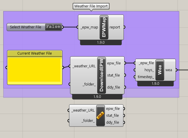

I’m running into a recurring issue with Ladybug/Honeybee in Grasshopper.
When I open my Grasshopper file, all LB/HB components show up marked as “OLD” as if they were the legacy tools. After a few seconds, the components already in place lose this tag, but any new components I insert into the canvas keep the “OLD” label.
I tried using the LB Legacy Updater and, suddenly, all components stopped showing the “OLD” tag. However, after reinstalling LB Tools for an unrelated issue, the label started appearing again in all new components.

I also noticed that all the new commponents seem to have lost the “1.9.0” labell that the original components displayed:
Captura de pantalla 2025-09-04 083918
I found the following disscussion in the forum: OLD tag on search construction set component in LBT 1.9 - #5 by chris.

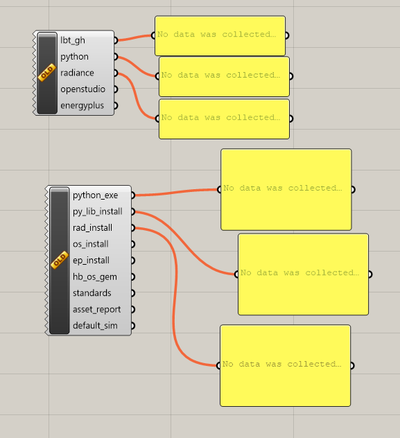

I believe my problem might be something deeper. Running: the “HB Check Versions ()” and the “HB_Config ()” components I get null results in all panels. At this point I assume I have to re-install everything again.

At the time, I hadn’t locked the solver (I didn’t have the padlock icon on the left or the red border), as there were no calculations running that I needed to keep.
Regarding the “OLD” label issue, it seems to be resolved. I did a clean reinstallation of Ladybug Tools, and now the components are showing up correctly. For now, everything seems to be working normally.
So, maybe the problem was just some kind of installation error?
Thanks again for all your help!
I did some more testing with the lock feature on Ladybug Tools components. I confirmed that when I lock the canvas, any component I insert from LB, HB, or HB Radiance gets labeled as “OLD”. However, when I insert a basic Grasshopper component, it doesn’t have the same label. As soon as I unlock the canvas, the LB and related components lose the “OLD” tag and revert to their normal 1.9.0 version label.
