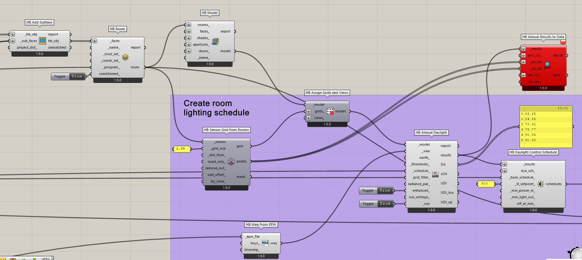

Problem connecting "HB Annual Daylight" to "HB Annual Results to Data" components
Hello! I am having a problem when connecting the “results” output of “HB Annual Daylight” component to the “HB Annual Results to Data” component. The following error report appears: “1. Solution exception:Extra data: line 1 column 614781 - line 4 column 1 (char 614780 - 614965)”.
However when I connect the same result output to others components as “HB Daylight Control Schedule”, it seems to work perfectly. I have also tried to use the “HB Annual Results to Data” component with imageless annual glare results and it works…
I wonder if it is a bug or there is a problem with my installation. I also get the following warning messages when running the simulation; maybe it is related to my problem?
“INFO: gendaymtx: warning - unusually bright at 7.5 on 12-20” and so on for various days of the year
“INFO: Expecting value: line 1 column 1 (char 0)”
“INFO: Failed to load paths from C:\Program Files\ladybug_tools\python\li\site-packages\ladybug\config.json.”
Hope you can help me! Thanks!

Hi @Maureen,
You should be able to upload files now.
Perhaps the issue stems from the line, INFO: Expecting value: line 1 column 1 (char 0), though I can not deduce from the log what it refers to. The other line, INFO: Failed to load paths from C:\Program Files\ladybug_tools\python\li\site-packages\ladybug\config.json, is likely an installation issue.
How did you install the plugin? If you are able to I suggest that you use the single-click installer. See the first section in this post.
If you already used the single-click installer, and it did not solve the issue, are you able to share the whole project folder? That should be the folder in the following path:
C:/Users/muzav/simulation/Test_HB_annual_daylight/annual_daylight_enhanced
You have to zip the folder, and if it exceeds the size limit to upload here you will have to share it on Google Drive or something similar. Please also share the Grasshopper file with internalized geometry.
Hi Mikkel, I had installed the ladybug-tools-1-9-0 plug-in from food4rhino, but after reinstalling Pollination as you suggested, everything works perfectly now. Thanks a lot for your help!

Hi @Maureen,
It is complaining about a file that cannot be found. The only issue is that the file path supposedly is an empty string.
Can you try to add a debug folder to the recipe by using the HB Recipe Settings component. Please share the contents of the debug folder in a zip file.
Hi @Maureen,
I was able to recreate it and fixed the bug. You should be able to get the fix by updating your core libraries with LB Versioner within an hour.
Hi @Mikkel, it works perfectly now, thank you so much!
