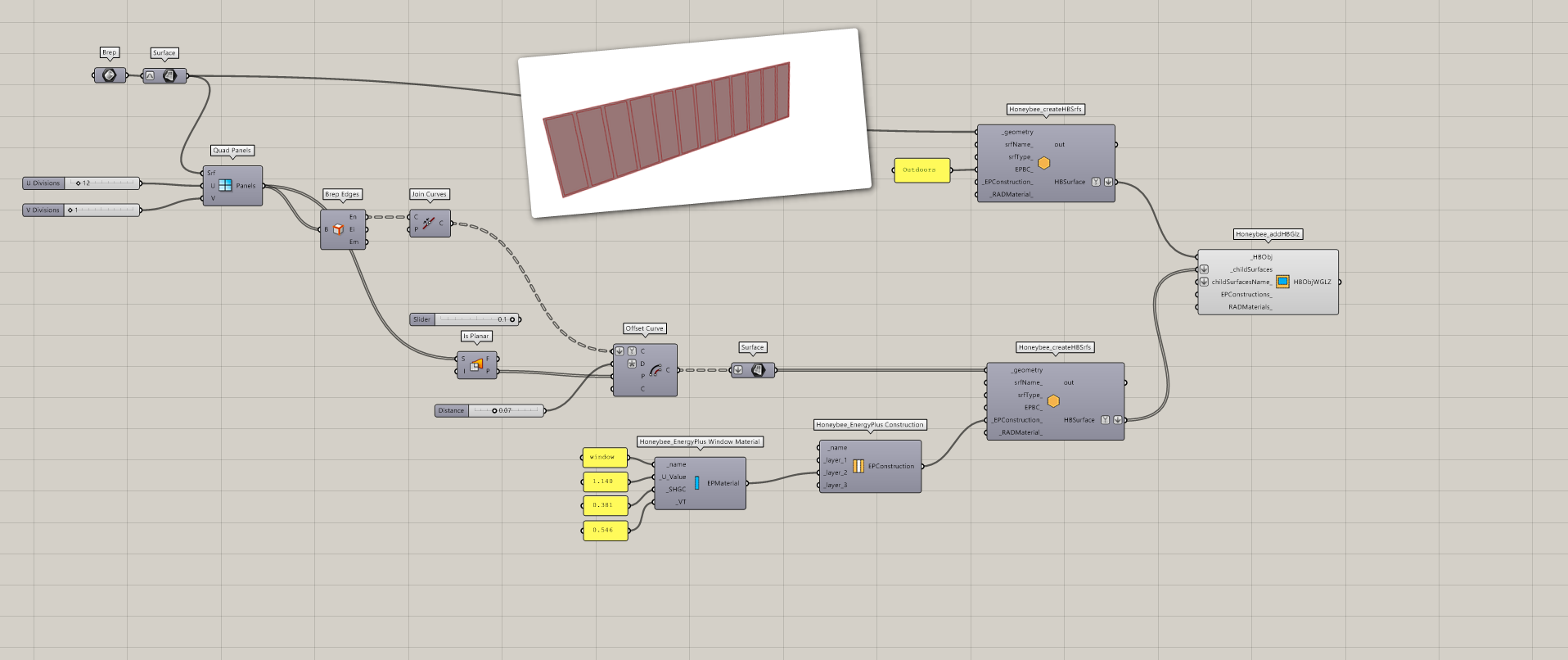

Hi, I have a problem with a gh file, it doesn’t read windows of the building instead the same file open on my friend’s pc runs well.
Foto%201
Honeybee_HBGlz doesn’t show windows created as child surfaces but only the HBsurface without them.
Foto%203
Thanks in advance for your reply.

@ambror, You forgot to internalise the geometries in GH file.
Chiled surfaces must be located on the normal of the base surface.
File_addglz_omr.gh (489.2 KB)
I open your file but the problem is the same: when I enable preview on HB_createHBSrfs I see windows.
But when I enable preview on HB_addglz I see only the surface without windows, so when I run the analysis it doesn’t read windows.

if you are using Rhino 6 you probably need to update HB. This issue was discussed about a month ago.
