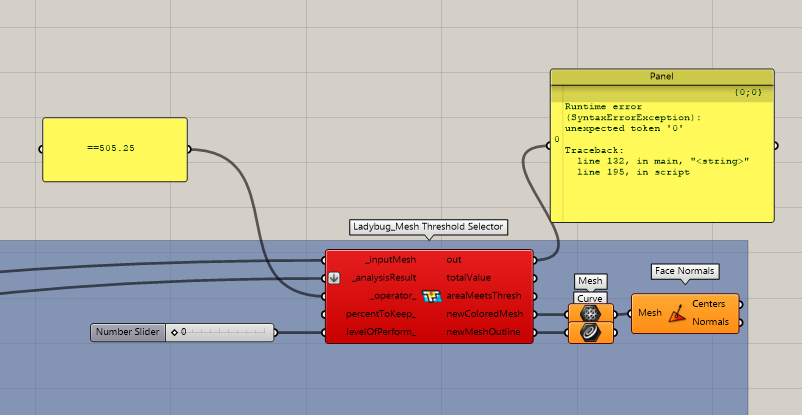

I would appreciate the help with a problem I am having with Ladybug Mesh Threshold Selector.
After Performing a radiation analysis process on a brep I am trying to select different meshes based on the amount of radiation, However the conditional statement in the operator fails to gather data and only the percentage to keep controls the resulting mesh.
I would very much appreciate the help.

The panel you connected to the operator input is wrong.
It should have only the operator sign, as the hing says, without a value. i.e. >, >=, < etc. I’ve found a bug, though, and it is that the == is not working.
The value goes into the levelOfPerformance input.

The LevelOfPerform doesn’t make any change as long as it is hooked up with a number, it’s absence is what makes the difference.Lady Bug 6-5.gh (431.2 KB)
I don’t recommend changing the code, not becouse it is not good but becouse you’ll loose the changes on any update and you need to remember what are the changes. If you want you can open an issue in github suggesting the change or add an option of inputing a domain.
Saying that, it is possible to filter a domain using the component twice in tandem. See attached.
