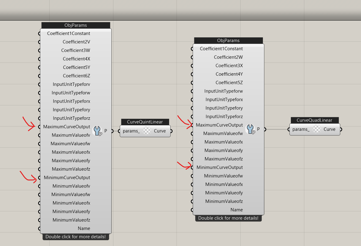

The default curves did not have a minimum or maximum curve output. In theory, there is a way to change the curves for both the heating and cooling WSHP EquationFit coils, but they require QuadLinear and QuintLinear curve types as an input which do not exist in Ironbug. I can set each individual coefficient, but not the min or max output as I can in the curve.
I was able to get around this for now by using C# to automatically modify the curves in the IDF as I was running it. By my question is, can QuadLinear and QuintLinear curve types be added to IB and/or a way of setting a max and min be added to the obj params because it seems like the default curves can get wacky sometimes.

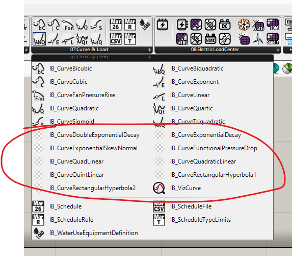

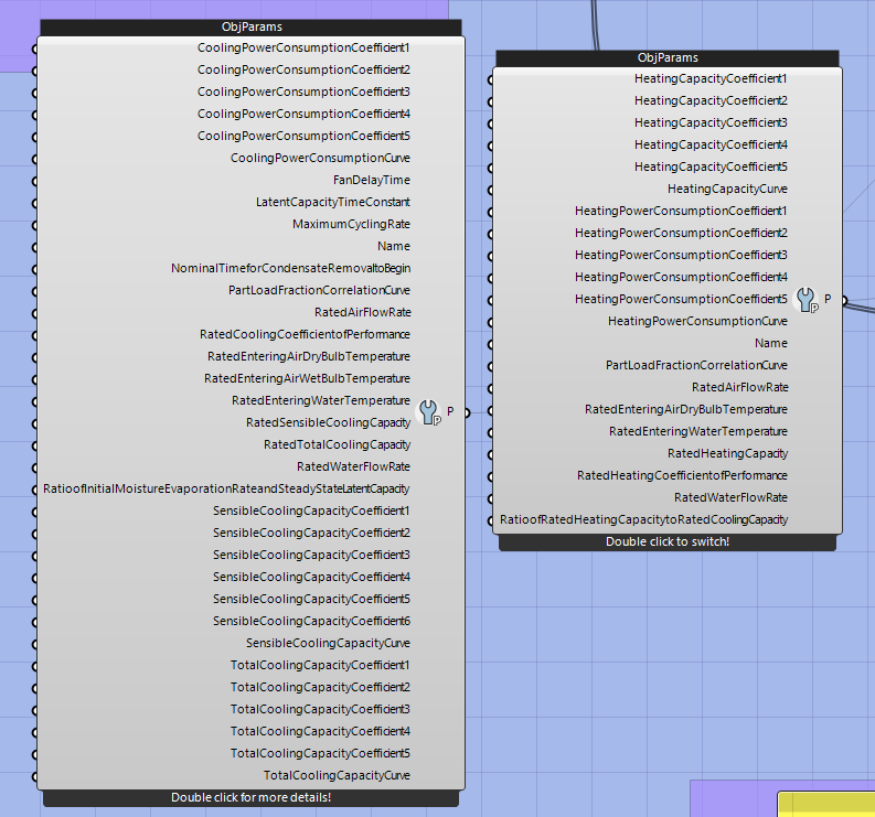

I have added all missing curve types (including QuadLinear and QuintLinear) that are available in OpenStudio, and the minimum and maximum curve output are also accessible via ObjParams (see screenshots below).
A new version of the Ironbug installer should be available soon.
