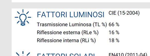

I am running an annual daylight study for a Honeybee model of a room in my project. In the Technical document for window specifications of project, I have Glazing Transmission and Internal reflection which I want to set in Grashopper. But in the “HB Glass Modifier” componant there is no input for reflection.
Could you please tell me how Glass Reflection is considered in this componant and if there is any way that I can set it?
