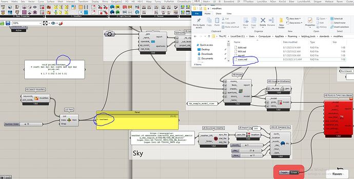

Hi @chris
I’m trying to run this file and I’m getting a strange error.
Is this file incompatible with the new version of Ladybug Tools?
  1. Solution exception:
    The recipe failed to run with the following error(s):
2025-08-23 03:22:45 ERROR: “SplitView” failed. See below for more information:
rpict -aa 0.1 -ab 2 -ad 2048 -af C:/Users/Compulyzer/AppData/Local/Temp/SplitView-29yxl_3n/output/view.amb -ar 64 -x 64 -y 64 -vf C:/Users/Compulyzer/AppData/Local/Temp/SplitView-29yxl_3n/view.vf C:/Users/Compulyzer/AppData/Local/Temp/SplitView-29yxl_3n/scene.oct > C:/Users/Compulyzer/AppData/Local/Temp/SplitView-29yxl_3n/output/view.unf
