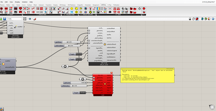

I had some trouble installing ladybug to my computer, to solve the problem I installed pollination and it looked that everything was working fine, but when a tried to do a radiation y get this message
(see attachment). Does someone is having the same problem? Or has any recommendation?
Appreciate the help.
You are plugging a Ladybug Legacy component into a LBT Ladybug component. You need to stick to one version or the other if you want all of the components to work together.
