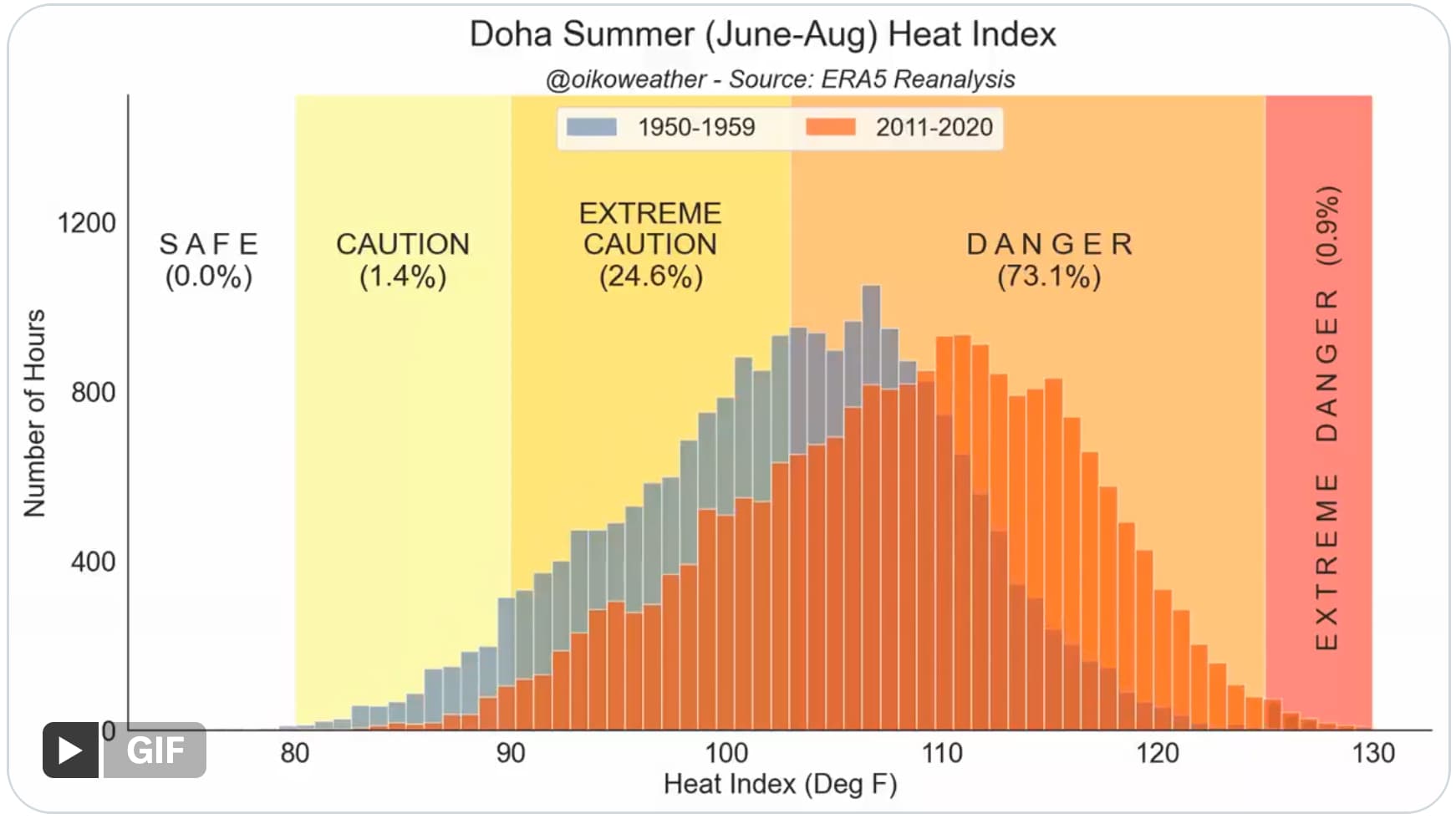

In general, I understand the idea is that the changing climate will have effects of shifting and flattening the distribution of some parameters. We can see this from historical data as shown below:
I understand these generators use CMIP models to estimate the magnitude of ‘shift’ and ‘flattening’ that they can apply to the present weather data and I think that’s more or less reasonable way to do it. One recommendation that I made in the past was to make sure an up-to-date EPW file is used, as some older TMY3 files include data from 1960s and 1970s, to avoid ‘garbage-in garbage-out’ type of situation.
