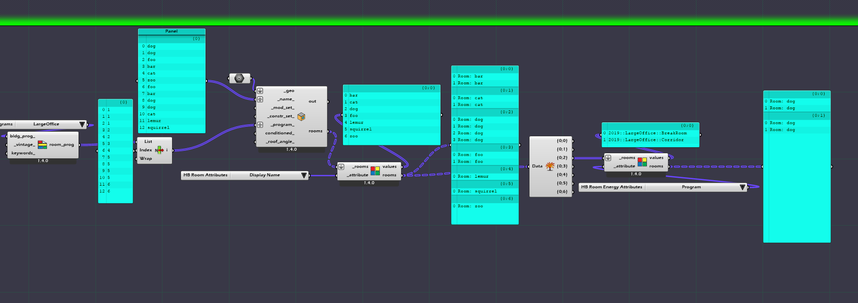

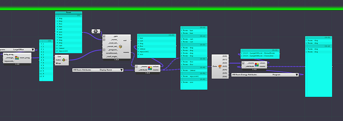

I think I got a little confused; is what you are wanting to do different than this?
sorting_rooms_1.4.0.gh (25.1 KB)
I totally forgot that we already had a Honeybee component for that, @TrevorFedyna . Thank you for catching this. Here’s the detailed documentation for the component if you need it, @compdesigner-nz
